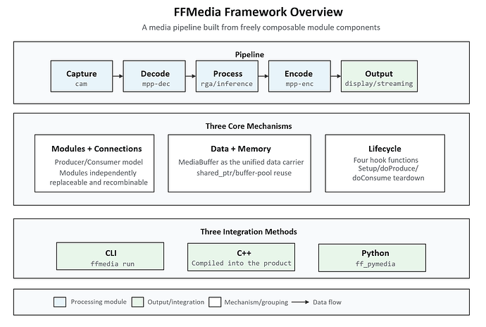

FFMedia is a modular audio/video processing framework for multimedia applications on RK Linux.
It is deeply adapted to the hardware capabilities of Rockchip platforms:
  • MPP — hardware video codec
  • RGA — 2D image acceleration (scaling, cropping, rotation, format conversion)
  • DRM/KMS — display output
  • EGL/GLES — graphics rendering
  • RKNN — NPU neural network inference
It covers every stage of a complete media pipeline: capture, reading, decoding, image processing, inference, encoding, display, muxing, and network output.

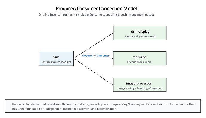

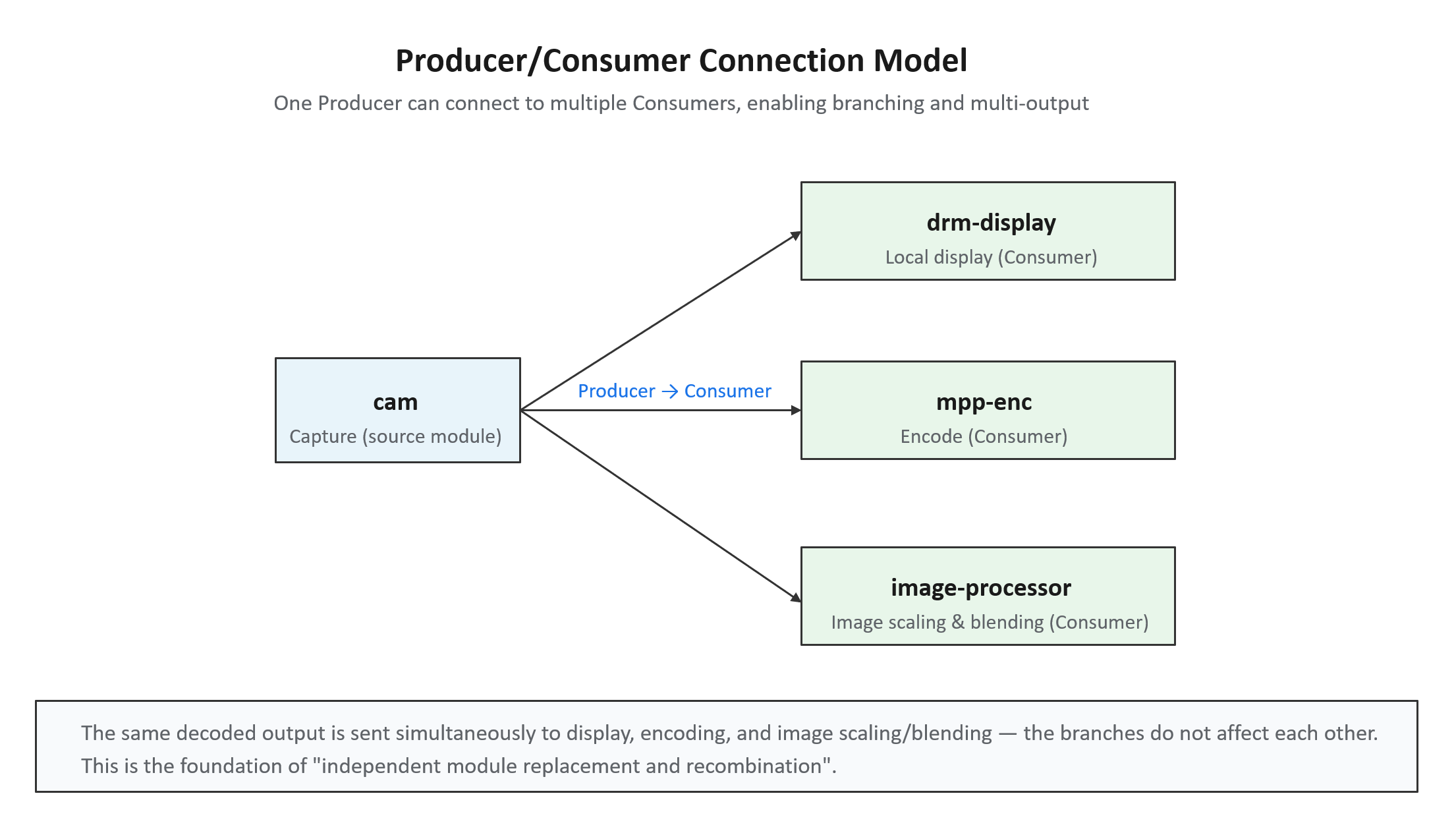

The Producer/Consumer Model
All modules are uniformly based on ModuleMedia. Source modules produce data via doProduce(); processing modules consume data via doConsume() and may continue to produce output; output modules handle display, file writing, or network transmission.
A Producer can connect to multiple Consumers, enabling branching, multi-output, multi-input processing pipelines.
The same decoder output can simultaneously be sent to display and to encoding/streaming, with the two branches not affecting each other.

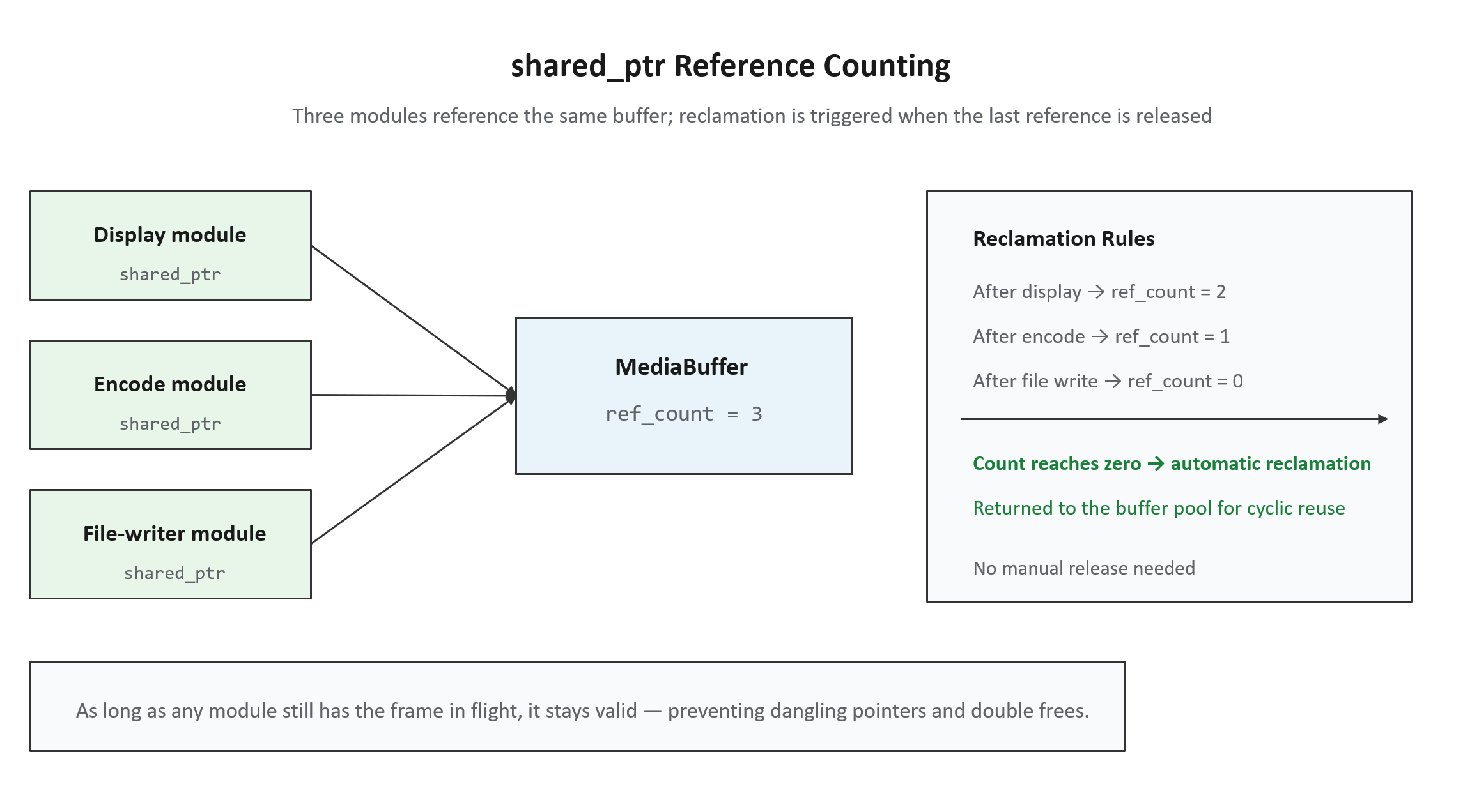

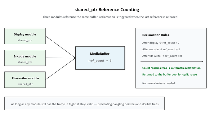

Unified MediaBuffer and Smart Pointers
Modules pass data between each other via std::shared_ptr<MediaBuffer>. MediaBuffer uniformly carries the payload, PTS/DTS, media type, codec format, image or audio parameters, channel ID, and additional data.
Why use shared_ptr: a buffer may be referenced simultaneously by multiple modules such as display, encoding, and file writing. Who is responsible for releasing it, and when it is safe to release, are error-prone questions with raw pointers (dangling pointers, double frees, memory leaks).
std::shared_ptr solves this via reference counting: each module holds a shared_ptr pointing to the same buffer, so the reference count is 3; when each module finishes using it and destroys its pointer, the count decreases by 1; memory is only reclaimed automatically when the last reference is released.
In other words, “in-flight frames are kept alive by shared pointers” — as long as any module is still using the frame, it will not be reclaimed.
Buffer pool: output buffers use a fixed pool with cyclic reuse to avoid the overhead of frequent new/delete (especially important for real-time systems). shared_ptr works together with this: while an in-flight buffer’s count is non-zero, it will not be returned to the pool; only when the count reaches zero is it allowed back into the pool for reuse.

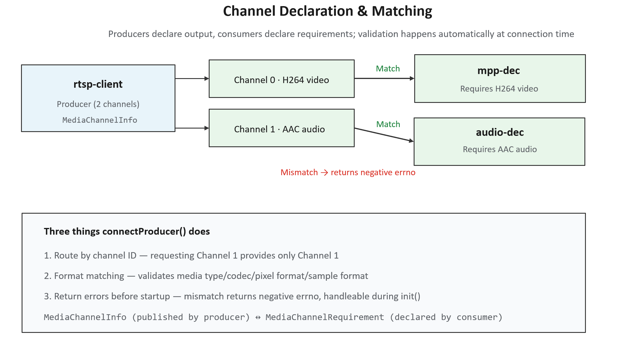

Channel Declaration and Connection Matching
Producers publish MediaChannelInfo, consumers declare MediaChannelRequirement, and connectProducer() does three things:
  1. Route by channel ID — requesting Channel 1 means only Channel 1 is provided;
  2. Format matching — validates media type, codec, pixel format, and sample format;
  3. Return errors before startup — on mismatch, it returns a negative errno that can be handled during the init() phase.
For example, an rtsp-client simultaneously outputs video (Channel 0, H264) and audio (Channel 1, AAC); the downstream video decoder and audio decoder each take what they need:

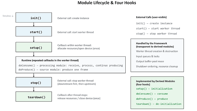

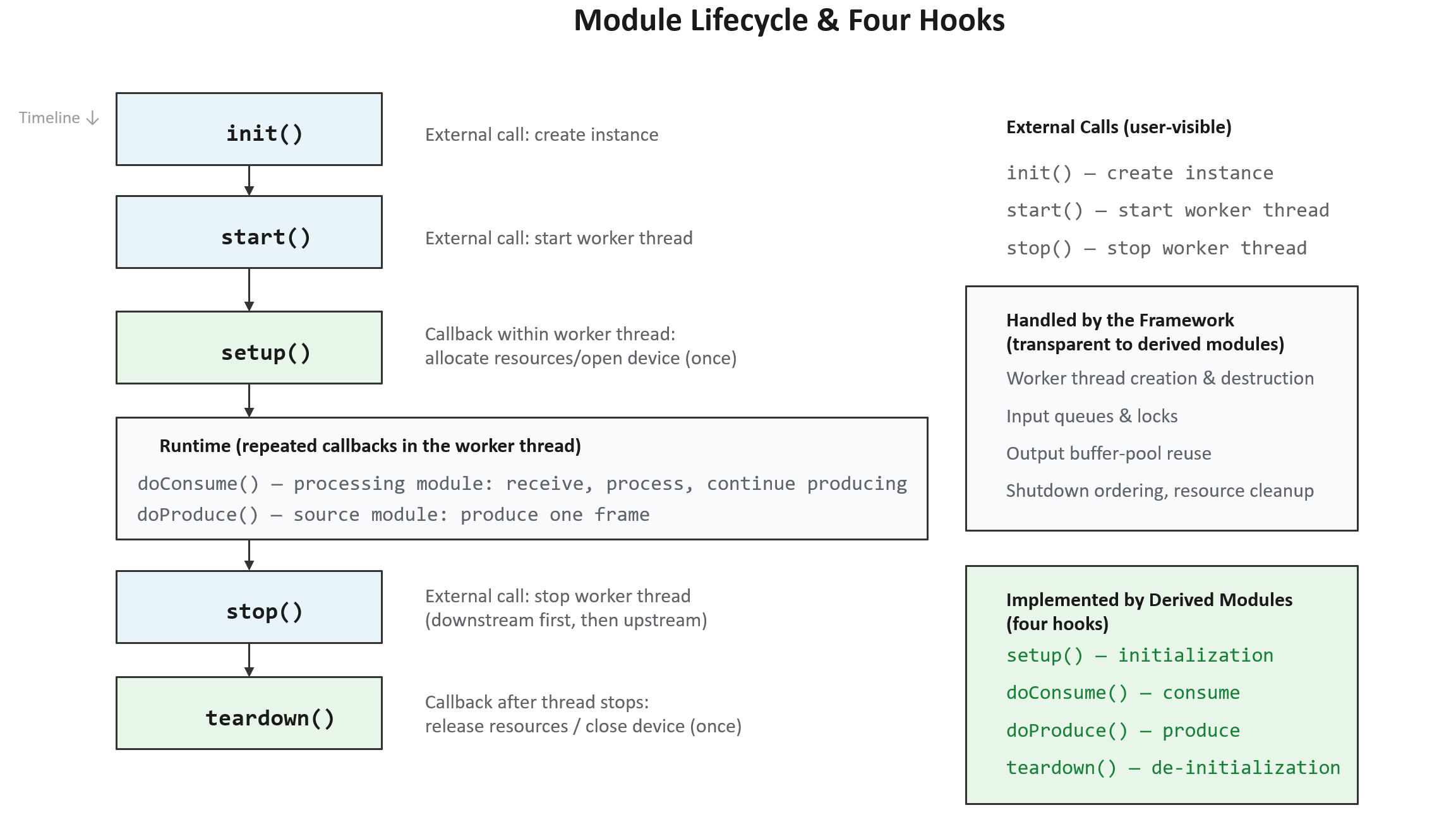

Module Lifecycle: Four Hooks
ModuleMedia centralizes threads, queues, buffer pools, shutdown ordering, and resource cleanup in the base class; derived modules only need to implement four hooks:
Hook When Called Responsibility
setup() Once, before startup Allocate resources, open devices, parse parameters
doConsume() Repeatedly, at runtime Processing modules: receive a frame, process it, continue producing
doProduce() Repeatedly, at runtime Source modules: produce a frame (e.g., capture)
teardown() Once, after stopping Release resources, close devices
Full lifecycle: init() → start() → setup() → [doConsume/doProduce called repeatedly at runtime] → stop() → teardown().
Among these, init(), start(), and stop() are called directly by business code; setup(), doConsume(), doProduce(), and teardown() are implemented by derived modules and invoked by the framework on the correct worker thread.
Shutdown ordering: the framework guarantees the correct “downstream first, then upstream” shutdown order. If capture (upstream) is stopped before the decoder (downstream), the decoder may still be processing a buffer whose pool has already been reclaimed by upstream, causing concurrency errors. This is one of the most common and hardest-to-diagnose classes of bugs in hand-written multithreaded implementations, and the framework eliminates it uniformly.
Module Categories
FFMedia divides modules into three categories corresponding to their role in the pipeline. The following category codes appear in the output of the ffmedia modules command:
Category Code Full Name Meaning Position in the Pipeline
vi video/audio input Input Pipeline source (capture/reading)
vp video/audio process Processing Pipeline middle (decoding/processing/inference)
vo video/audio output Output Pipeline end (display/writing/sending)
Modules actually provided by the SDK (v2.6.1):
Category Modules Purpose
Input (vi) cam, file-reader, rtsp-client, rtmp-client, ffmpeg-demux, alsa-capture, mem-reader Camera, file, network stream, FFmpeg demuxing, audio capture, application-fed memory
Processing (vp) mpp-dec, mpp-enc, rga, image-processor, video-stack, inference, aac-dec, aac-enc Hardware codec, image processing, multi-stream compositing, RKNN inference, audio codec
Output (vo) drm-display, file-writer, rtsp-server, rtmp-server, gb28181-client, ffmpeg-mux, renderer-video, alsa-playback Display, file writing, streaming, muxing, window rendering, audio playback
Integration Methods
FFMedia offers three integration methods, suited to different stages:
Method Positioning Typical Scenarios
CLI Quick validation via command line Environment validation, module validation
C++ Compiled into the product, deep integration Production deployment
Python Script orchestration, rapid prototyping Early prototypes, automated testing

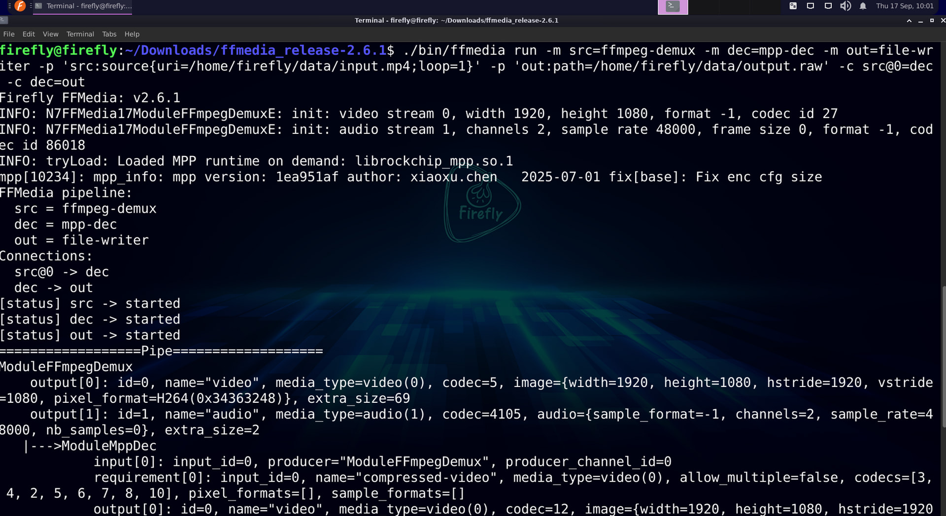

CLI
ffmedia modules   # List available modules
ffmedia params    # Show module parameters
ffmedia run       # Run a pipeline
Can be combined with --trace, --trace-latency, and --trace-local-latency to observe the pipeline.

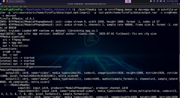

Listing Actually Available Modules with ffmedia modules

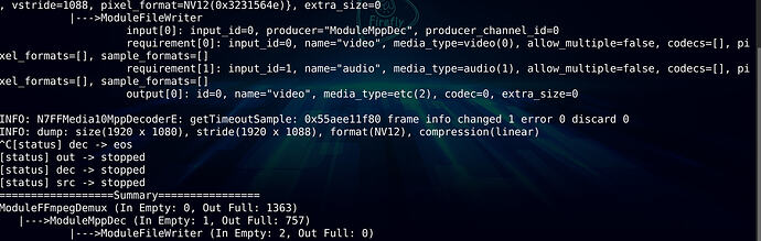

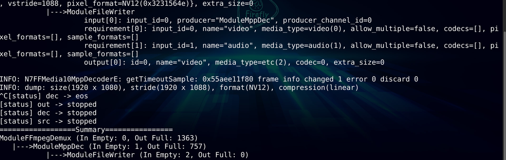

Running ffmedia modules lists all modules compiled into the current SDK. Below is real output from a Firefly device (v2.6.1):
$ ./ffmedia modules
Firefly FFMedia: v2.6.1
TYPE                CLASS GRAPH     DESCRIPTION
cam                 vi    yes       V4L2 camera source
file-reader         vi    yes       File/container source
rtsp-client         vi    yes       RTSP source
rtmp-client         vi    yes       RTMP source or publisher selected by source/publish
mem-reader          vi    special   Application-fed memory source
video-stack         vp    yes       Composite processor with configured input layouts
ffmpeg-demux        vi    yes       FFmpeg input source
alsa-capture        vi    yes       ALSA capture source
mpp-dec             vp    yes       Rockchip MPP decoder
mpp-enc             vp    yes       Rockchip MPP encoder
rga                 vp    yes       Rockchip RGA processor
image-processor     vp    yes       EGL/OpenGL image processor
inference           vp    yes       RKNN inference processor
aac-dec             vp    yes       FDK-AAC decoder
aac-enc             vp    yes       FDK-AAC encoder
drm-display         vo    yes       DRM display sink
file-writer         vo    yes       File output sink
rtsp-server         vo    yes       RTSP server sink
rtmp-server         vo    yes       RTMP server sink
gb28181-client      vo    yes       GB28181 client sink
ffmpeg-mux          vo    yes       FFmpeg output muxer
renderer-video      vo    yes       Window video renderer
alsa-playback       vo    yes       ALSA playback sink

Running a Pipeline End-to-End with ffmedia run
A single complete command ties together the core concepts described above. The goal: read an MP4 file → hardware decode → output an elementary stream.
./ffmedia run \
  -m src=ffmpeg-demux -m dec=mpp-dec -m out=file-writer \
  -p 'src:source{uri=/home/firefly/data/input.mp4;loop=1}' \
  -p 'out:path=/home/firefly/data/output.raw' \
  -c src@0=dec -c dec=out
Command syntax breakdown:
Option Purpose Example
-m name=type Define a module instance: specify name and type src=ffmpeg-demux
-p 'name:param{...}' Set module parameters src:source{uri=...;loop=1}
-c from@ch=to Define a connection: a given channel of one module → target module src@0=dec
This command defines three modules (src/dec/out), two parameter settings (source file path and output path), and two connections (src@0 → dec, dec → out). The -p syntax is: the parameter name after the colon, sub-parameters inside curly braces, with multiple items separated by semicolons.
Interpreting the output — mapping to three core concepts:
The first is lifecycle states:
[status] src -> started
[status] dec -> started
[status] out -> started
The three modules each move from created to started in turn — the practical manifestation of init() → setup() → start().
The second is channel matching: in the pipeline graph printed by dumpPipe(), you can see each connection’s “producer declaration + consumer requirement”:
|--->ModuleMppDec
input[0]: input_id=0, producer="ModuleFFmpegDemux", producer_channel_id=0
requirement[0]: name="compressed-video", media_type=video(0),
                codecs=[3, 4, 2, 5, 6, 7, 8, 10], ...
  • producer_channel_id=0 indicates it connects to the upstream’s channel 0 (the video stream);
  • requirement[0] is the full content of a MediaChannelRequirement: name, media type, codecs whitelist (acceptable codec formats), and pixel format whitelist;
  • The upstream src outputs codec=5 (H264), which falls within dec’s codecs=[...5...] whitelist, so the match succeeds.
The third is data flow via the unified MediaBuffer: data is “transformed” step by step across the three modules:
src  output[0]: codec=5(H264 compressed stream), image={width=1080, height=1920, pixel_format=H264}
dec  output[0]: codec=12(raw pixels),  image={width=1080, height=1920, pixel_format=NV12, hstride=1088}
out  output[0]: media_type=etc(2)
Before decoding it is an H264 compressed stream; after decoding it becomes NV12 raw pixels (where hstride changes from 1080 to 1088 due to hardware alignment), and finally it is written out. The MediaBuffer at each stage carries the complete media description.
Connection overview (corresponding to the -c options in the command):
src@0 -> dec      # src's channel 0 (video) feeds into dec
dec -> out        # dec's default output feeds into out
Finally, the ==================Pipe=================== section in the ffmedia run output is a complete snapshot from dumpPipe(); the trailing dump: size(...) stride(...) format(NV12) ... is the summary from dumpPipeSummary().
