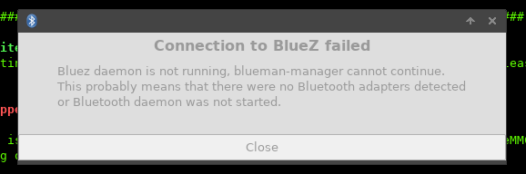

ArmbianTV ver 20.11
To enable BT in Armbian, you need to install the full firmware package. This can be easily done either through the “armbian-config” or through the standard DEB package (apt install armbian-firmware-full) installation tools. After installing the firmware, turn on BT and restart the system.
