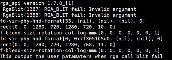

播放rstp视频流时,提示如下rga报错信息,有无解决方法?
rga_api version 1.7.0_[1]
 RgaBlit(1387) RGA_BLIT fail: Invalid argument
 RgaBlit(1388) RGA_BLIT fail: Invalid argument
fd-vir-phy-hnd-format[33, (nil), (nil), (nil), 0]
rect[0, 0, 1280, 720, 1280, 720, 10, 0]
f-blend-size-rotation-col-log-mmu[0, 0, 0, 0, 0, 0, 1]
fd-vir-phy-hnd-format[0, 0x7f3051b5d0, (nil), (nil), 0]
rect[0, 0, 1280, 720, 1280, 768, 11, 0]
This output the user patamaters when rga call blit fail
