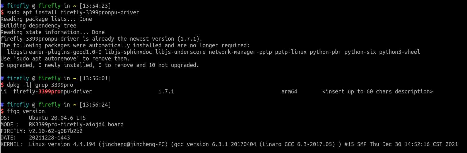

大佬,在线急求!!!感激不尽!请问可以帮忙看看吗?我重新刷了固件(AIO-RK3399PRO-JD4-UBUNTU-20.04_DESKTOP-GPT-20211230-1511.img),也按照指示安装好了3399pronpu驱动,但是输入npu_transfer_proxy devices,没有任何显示,请问怎么解决?我也尝试把 npu_firmware/npu_fw/*所有文件拷贝到 /vendor/etc/firmware/ 路径下,重启还是没有输出任何信息,参考这个链接RKNPU For RK3399Pro
firefly@firefly:~$ dpkg -l | grep 3399pronpuii firefly-3399pronpu-driver 1.7.1 arm64 <insert up to 60 chars description>firefly@firefly:~$ ps -ef | grep npu_transfer_proxyroot 1231 1 0 07:45 ? 00:00:00 /usr/bin/npu_transfer_proxyfirefly 1372 1358 0 07:50 pts/1 00:00:00 grep --color=auto npu_transfer_proxyfirefly@firefly:~$ npu_transfer_proxy devicesList of ntb devices attachedfirefly@firefly:~$ ffgo versionOS: Ubuntu 20.04.3 LTSMODEL: RK3399pro-firefly-aiojd4 boardFIREFLY: v2.10-62-g087b2b2DATE: 20211228-1443KERNEL: Linux version 4.4.194 (jincheng@jincheng-PC) (gcc version 6.3.1 20170404 (Linaro GCC 6.3-2017.05) ) #15 SMP Thu Dec 30 14:52:16 CST 2021
KevinWu 发表于 2023-5-23 16:03
大佬,在线急求!!!感激不尽!请问可以帮忙看看吗?我重新刷了固件(AIO-RK3399PRO-JD4-UBUNTU-20.04_ …
紧急的话,可以发送邮件到service@t-firefly.com
