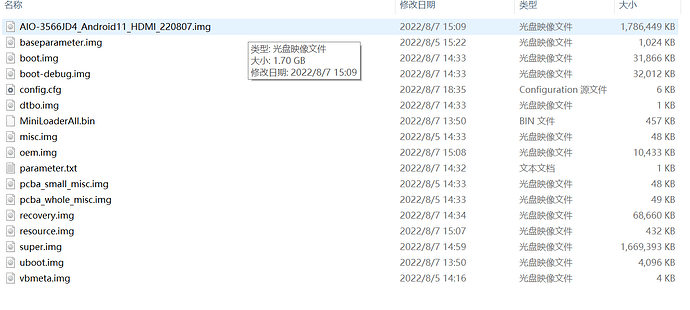

lpmake I 08-07 14:59:14 49383 49383 builder.cpp:1031] [liblp]Partition product will resize from 0 bytes to 194351104 bytes
lpmake I 08-07 14:59:14 49383 49383 builder.cpp:1031] [liblp]Partition odm will resize from 0 bytes to 634880 bytes
2022-08-07 14:59:43 - build_super_image.py - INFO : Done writing image out/target/product/rk3566_firefly_aiojd4/super.img
#### build completed successfully (48:50 (mm:ss)) ####
Build android ok!
====== make and copy android images
./mkimage.sh
TARGET_PRODUCT=rk3566_firefly_aiojd4
TARGET_BASE_PARAMETER_IMAGE==device/rockchip/rk356x_box/etc/baseparameter_auto.img
HIGH_RELIABLE_RECOVERY_OTA=
BOARD_AVB_ENABLE=false
system filesysystem is ext4
create dtbo.img…
done.
create resource.img…
done.
create boot.img…
done.
create boot-debug.img…
done.
skip copy images: vendor_boot.img
skip copy images: vendor_boot-debug.img
create recovery.img…
done.
create super.img…
done.
create vbmeta.img…
BOARD_AVB_ENABLE is false, use default vbmeta.img
create misc.img… done.
create uboot.img…
make oem images…
u-boot/trust.img not fount! Please make it from u-boot first!
create loader…
create config.cfg…
create baseparameter…done.
Make image ok!
zcp@ubuntu:~/proj/RK356X_Android11.0$

我用root权限改了 你说的 设备树节点, 编译后我复制/home/zcp/proj/RK356X_Android11.0/kernel 这个新编译的boot.img ,开发板进入loader模式直接烧这一个文件,系统还是到不了android桌面。
不应该啊,你改的哪里的文件?为什么要root权限去改?
/home/zcp/proj/RK356X_Android11.0/kernel/arch/arm64/boot/dts/rockchip 我只是用进入root 用了gedit 改了你说的节点,
我只改你说的节点
&dfi {
status = “okay”;
&dmc {
status = “disabled”;
&vcc3v3_pcie{
status=“disabled”;
文件权限是 rk3566-firefly-aiojd4.dtsi
-rw-rw-r-- 1 zcp zcp 7.9K Aug 8 10:36 rk3566-firefly-aiojd4.dtsi
我想问下,我去拆开公版的boot 然后烧我自己系统,再烧公版的boot 是不是先可以跑起来我自己的系统
Liuth 发表于 2022-8-8 10:17
你把SDK/kernel/arch/arm64/boot/dts/rockchip/rk3566-firefly-aiojd4.dtsi
里面,dmc节点的status,从o …
已经进入android系统桌面了,我是拿着公版的系统android11镜像拆开了boot给,我自己编译的andorid系统 重烧公网的boot。我希望有空时候,解决我自己编译的boot能用啊。
