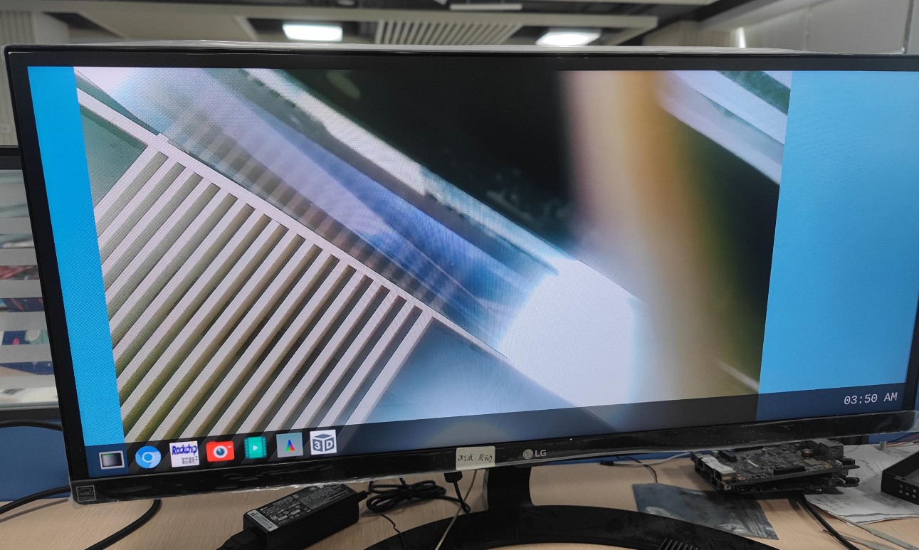

根据wiki资料,在调试camera的时候,调用v4l2-ctl --verbose -d /dev/video0 --set-fmt-video=width=1920,height=1080,pixelformat=‘NV12’ --stream-mmap=4 --set-selection=target=crop,flags=0,top=0,left=0,width=1920,height=1080 --stream-to=/userdata/out.yuv命令,发现报错,日志如下,请问是什么问题?
目前是ubuntu的固件,没做任何修改,接上了800w单目摄像。

我更新了固件,目前固件如下:
root@RK3588:/userdata# cat /proc/version
Linux version 5.10.110 (lvsx@tchip14) (kernel commit id: 44dbce6d6463) (sdk version: rk3588_linux_release_20221012_v1.0.2a) (aarch64-none-linux-gnu-gcc (GNU Toolchain for the A-profile Architecture 10.3-2021.07 (arm-10.29)) 10.3.1 20210621, GNU ld (GNU Toolchain for the A-profile Architecture 10.3-2021.07 (arm-10.29)) 2.36.1.20210621) #167 SMP Thu Oct 13 12:03:21 CST 2022
也是报如下的错误:

VIDIOC_STREAMON returned 0 (Success)
cap dqbuf: 0 seq: 0 bytesused: 3110400 ts: 367.351180 delta: 367351.180 ms (ts-monotonic, ts-src-eof)
cap dqbuf: 1 seq: 1 bytesused: 3110400 ts: 367.384508 (ts-monotonic, ts-src-eof)
cap dqbuf: 2 seq: 2 bytesused: 3110400 ts: 367.417937 (ts-monotonic, ts-src-eof)
cap dqbuf: 3 seq: 3 bytesused: 3110400 ts: 367.451178 (ts-monotonic, ts-src-eof)
[ 369.847947] mipi2-csi2 ERR1:0x1000000 (crc,vc: 0)
[ 369.848056] mipi2-csi2 ERR1:0x10000000 (ecc2)
[ 369.879299] rkcif-mipi-lvds2: ERROR: csi size err, intstat:0x1000001, lastline:296!!
[ 369.879416] mipi2-csi2 ERR1:0x110 (fs/fe mis,vc: 0) (f_seq,vc: 0)
[ 369.912659] mipi2-csi2 ERR1:0x110 (fs/fe mis,vc: 0) (f_seq,vc: 0)
cap dqbuf: 0 seq: 32 bytesused: 3110400 ts: 368.670797 fps: 24.25 dropped: 28 (ts-monotonic, ts-src-eof)
cap dqbuf: 1 seq: 33 bytesused: 3110400 ts: 368.704021 fps: 24.39 (ts-monotonic, ts-src-eof)
cap dqbuf: 2 seq: 34 bytesused: 3110400 ts: 368.737355 fps: 24.53 (ts-monotonic, ts-src-eof)
cap dqbuf: 3 seq: 35 bytesused: 3110400 ts: 368.770688 fps: 24.66 (ts-monotonic, ts-src-eof)
cap dqbuf: 0 seq: 36 bytesused: 3110400 ts: 368.804022 fps: 24.78 (ts-monotonic, ts-src-eof)
cap dqbuf: 1 seq: 37 bytesused: 3110400 ts: 368.837355 fps: 24.90 (ts-monotonic, ts-src-eof)
cap dqbuf: 2 seq: 38 bytesused: 3110400 ts: 368.870738 fps: 25.01 (ts-monotonic, ts-src-eof)
cap dqbuf: 3 seq: 39 bytesused: 3110400 ts: 368.904083 fps: 25.11 (ts-monotonic, ts-src-eof)
cap dqbuf: 0 seq: 40 bytesused: 3110400 ts: 368.937355 fps: 25.22 (ts-monotonic, ts-src-eof)
cap dqbuf: 1 seq: 41 bytesused: 3110400 ts: 368.970687 fps: 25.32 (ts-monotonic, ts-src-eof)
cap dqbuf: 2 seq: 42 bytesused: 3110400 ts: 369.004021 fps: 25.41 (ts-monotonic, ts-src-eof)
cap dqbuf: 3 seq: 43 bytesused: 3110400 ts: 369.037355 fps: 25.50 (ts-monotonic, ts-src-eof)
cap dqbuf: 0 seq: 44 bytesused: 3110400 ts: 369.070688 fps: 25.59 (ts-monotonic, ts-src-eof)
cap dqbuf: 1 seq: 45 bytesused: 3110400 ts: 369.104021 fps: 25.67 (ts-monotonic, ts-src-eof)
cap dqbuf: 2 seq: 46 bytesused: 3110400 ts: 369.137354 fps: 25.75 (ts-monotonic, ts-src-eof)
cap dqbuf: 3 seq: 47 bytesused: 3110400 ts: 369.170688 fps: 25.83 (ts-monotonic, ts-src-eof)
cap dqbuf: 0 seq: 48 bytesused: 3110400 ts: 369.204021 fps: 25.91 (ts-monotonic, ts-src-eof)
cap dqbuf: 1 seq: 49 bytesused: 3110400 ts: 369.237355 fps: 25.98 (ts-monotonic, ts-src-eof)
cap dqbuf: 2 seq: 50 bytesused: 3110400 ts: 369.270687 fps: 26.05 (ts-monotonic, ts-src-eof)
cap dqbuf: 3 seq: 51 bytesused: 3110400 ts: 369.304021 fps: 26.12 (ts-monotonic, ts-src-eof)
cap dqbuf: 0 seq: 52 bytesused: 3110400 ts: 369.337355 fps: 26.18 (ts-monotonic, ts-src-eof)
cap dqbuf: 1 seq: 53 bytesused: 3110400 ts: 369.370687 fps: 26.24 (ts-monotonic, ts-src-eof)
cap dqbuf: 2 seq: 54 bytesused: 3110400 ts: 369.404083 fps: 26.30 (ts-monotonic, ts-src-eof)
cap dqbuf: 3 seq: 55 bytesused: 3110400 ts: 369.437355 fps: 26.36 (ts-monotonic, ts-src-eof)
cap dqbuf: 0 seq: 56 bytesused: 3110400 ts: 369.470688 fps: 26.42 (ts-monotonic, ts-src-eof)
cap dqbuf: 1 seq: 57 bytesused: 3110400 ts: 369.504021 fps: 26.48 (ts-monotonic, ts-src-eof)
cap dqbuf: 2 seq: 58 bytesused: 3110400 ts: 369.537354 fps: 26.53 (ts-monotonic, ts-src-eof)
cap dqbuf: 3 seq: 59 bytesused: 3110400 ts: 369.570688 fps: 26.58 (ts-monotonic, ts-src-eof)
cap dqbuf: 0 seq: 60 bytesused: 3110400 ts: 369.604021 fps: 26.63 (ts-monotonic, ts-src-eof)
cap dqbuf: 1 seq: 61 bytesused: 3110400 ts: 369.637355 fps: 26.68 (ts-monotonic, ts-src-eof)
cap dqbuf: 2 seq: 62 bytesused: 3110400 ts: 369.670689 fps: 26.73 (ts-monotonic, ts-src-eof)
cap dqbuf: 3 seq: 63 bytesused: 3110400 ts: 369.704020 fps: 26.78 (ts-monotonic, ts-src-eof)
cap dqbuf: 0 seq: 64 bytesused: 3110400 ts: 369.737355 fps: 26.82 (ts-monotonic, ts-src-eof)
cap dqbuf: 1 seq: 65 bytesused: 3110400 ts: 369.770688 fps: 26.86 (ts-monotonic, ts-src-eof)
cap dqbuf: 2 seq: 66 bytesused: 3110400 ts: 369.804021 fps: 26.91 (ts-monotonic, ts-src-eof)
cap dqbuf: 3 seq: 67 bytesused: 3110400 ts: 369.837355 fps: 26.95 (ts-monotonic, ts-src-eof)
cap dqbuf: 0 seq: 68 bytesused: 3110400 ts: 369.870688 fps: 26.99 (ts-monotonic, ts-src-eof)
cap dqbuf: 1 seq: 69 bytesused: 3110400 ts: 369.904082 fps: 27.03 (ts-monotonic, ts-src-eof)
cap dqbuf: 2 seq: 70 bytesused: 3110400 ts: 369.937355 fps: 27.07 (ts-monotonic, ts-src-eof)
cap dqbuf: 3 seq: 71 bytesused: 3110400 ts: 369.970688 fps: 27.10 (ts-monotonic, ts-src-eof)
cap dqbuf: 0 seq: 72 bytesused: 3110400 ts: 370.004021 fps: 27.14 (ts-monotonic, ts-src-eof)
cap dqbuf: 1 seq: 73 bytesused: 3110400 ts: 370.037355 fps: 27.18 (ts-monotonic, ts-src-eof)
cap dqbuf: 2 seq: 74 bytesused: 3110400 ts: 370.070689 fps: 27.21 (ts-monotonic, ts-src-eof)
cap dqbuf: 3 seq: 75 bytesused: 3110400 ts: 370.104021 fps: 27.24 (ts-monotonic, ts-src-eof)
cap dqbuf: 0 seq: 76 bytesused: 3110400 ts: 370.137355 fps: 27.28 (ts-monotonic, ts-src-eof)
cap dqbuf: 1 seq: 77 bytesused: 3110400 ts: 370.170688 fps: 27.31 (ts-monotonic, ts-src-eof)
cap dqbuf: 2 seq: 78 bytesused: 3110400 ts: 370.204021 fps: 27.34 (ts-monotonic, ts-src-eof)
cap dqbuf: 3 seq: 79 bytesused: 3110400 ts: 370.237354 fps: 27.37 (ts-monotonic, ts-src-eof)
cap dqbuf: 0 seq: 80 bytesused: 3110400 ts: 370.270687 fps: 27.40 (ts-monotonic, ts-src-eof)
cap dqbuf: 1 seq: 81 bytesused: 3110400 ts: 370.304021 fps: 27.43 (ts-monotonic, ts-src-eof)
cap dqbuf: 2 seq: 82 bytesused: 3110400 ts: 370.337354 fps: 27.46 (ts-monotonic, ts-src-eof)

板蓝根 发表于 2022-11-23 17:28
固件太久,更新固件
是升级的buildroot的固件。
如电话沟通:
固件版本无论是 ubuntu 还是 buildroot 都到了 1.0.4b 了,我看你的信息还是 1.0.2 版本
您说没有找到 gst-launch-1.0, 我检查了 buildroot 内部是默认内置了 gstreamer 的。并且可以成功预览,你可以使用以下命令:
gst-launch-1.0 v4l2src device=/dev/video0 io-mode=4 ! queue ! video/x-raw,format=NV12,width=1920,height=1080,framerate=30/1 ! waylandsink
如果需要用 v4l2-ctl 来抓图,需要使用 1.16.5 或之前的版本。或者自己写一个应用来抓。
板蓝根 发表于 2022-12-1 11:49
如电话沟通:
我使用上述gst命令可以成功预览了,请问gst命令可以用来抓图吗?
我也遇到这个问题,从打印看,不完全相同,但是非常类似,
chenzejun 发表于 2022-11-24 11:18
我更新了固件,目前固件如下:
这位大神你好,到了这里的第二步的和你差不多一样的报错,你是怎么解决的呢?谢谢。还请指教一下,不是固件问题了吧
