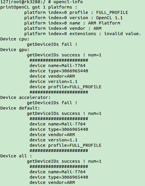

这里打印的信息请参考opencl文档 : https://www.khronos.org/registry/cl/specs/opencl-1.1.pdf
把编译好的opencl-info push到/system/bin目录下,把libGLES_mali.so push到/system/lib目录下,就可以在adb shell中运行opencl-info了。
从打印的信息可以看到,rk3288支持OpenCL 1.1,支持的设备是gpu的Mali-T764。

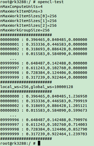

这里贴出一个简单的向量加法的例子,和容易出错的地方。先上代码:

    local_ws = 256;  //我们使用一维的clEnqueueNDRangeKernel,这里local_ws选择nMaxWorkItemSizes[0]=256
    global_ws = shrRoundUp(local_ws,size); //这里是线程总数,应该是local_ws的倍数。
    printf("local_ws=%d,global_ws=%d\n",local_ws,global_ws);

    clEnqueueReadBuffer(queue,outbuf_r,CL_TRUE,0,mem_size,vect_c,0,NULL,NULL);
    printVects();

这里说一下容易出错的地方:
(1)clCreateContext,网上有些例子把第一个参数置成0,经试验这样不行,要设置properties。
(2)clEnqueueNDRangeKernel的global_work_size和local_work_size。我们使用一维的clEnqueueNDRangeKernel,这里local_work_size选择nMaxWorkItemSizes[0]=256,global_work_size是线程总数,应该是local_ws的倍数。
一维情况下:
二维情况下:
(3)kernel代码中
size_t get_global_id (uint dimindx)
返回这个线程的global_id,参数是维度索引,我们一维的情况下参数是0。
最后运行结果:

printOpenCL got 1 platforms :
platform index=0 profile : FULL_PROFILE
platform index=0 version : OpenCL 1.1 v1.r6p0-02rel0.0f4218be5cc66c20a4
f31b6cc856ee46
platform index=0 name : ARM Platform
platform index=0 vendor : ARM
file /dev/mali0 is not of a compatible version (user 9.0, kernel 8.0)
ERROR: The DDK is not compatible with any of the Mali GPUs on the system.
The DDK was built for 0x750 r0p0 status range [1..1], but none of the GPUs match
ed:
platform index=0 extensions : out of host memory.
Device cpu:
ed:
getDeviceIDs fail !
Device gpu:
ed:
getDeviceIDs fail !
Device accelerator:
ed:
getDeviceIDs fail !
Device default:
ed:
getDeviceIDs fail !
Device all :
ed:
getDeviceIDs fail !
