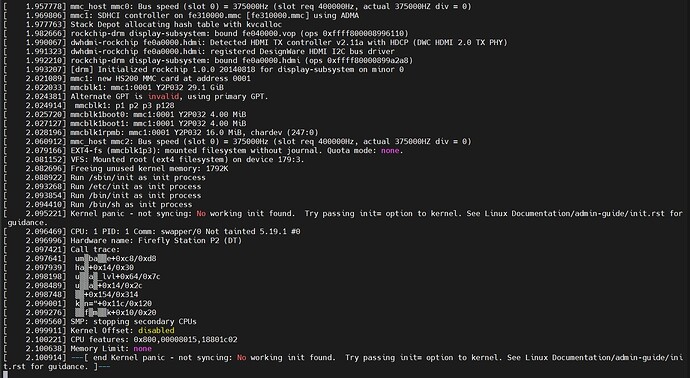

SDK包名称:Station_P2_LEDE_GPT_RAW_20230706
SDK修改内容:将glibc版本从2.34替换为2.31
Log日志:MobaXterm_COM7_20230706_160753.zip
将glibc版本替换为2.31后,代码可以正常编译,但是系统无法启
gcc:9.3.0 kernel:5.19.0
MobaXterm_COM7_20230706_160753.zip (11.3 KB)

[ 2.079166] EXT4-fs (mmcblk1p3): mounted filesystem without journal. Quota mode: none.
[ 2.081152] VFS: Mounted root (ext4 filesystem) on device 179:3.
[ 2.082696] Freeing unused kernel memory: 1792K
[ 2.088922] Run /sbin/init as init process
[ 2.093268] Run /etc/init as init process
[ 2.093854] Run /bin/init as init process
[ 2.094410] Run /bin/sh as init process
[ 2.095221] Kernel panic - not syncing: No working init found. Try passing init= option to kernel. See Linux Documentation/admin-guide/init.rst for guidance.
[ 2.096469] CPU: 1 PID: 1 Comm: swapper/0 Not tainted 5.19.1 #0
[ 2.096996] Hardware name: Firefly Station P2 (DT)
[ 2.097421] Call trace:
[ 2.097641] um▒ba▒▒e+0xc8/0xd8
[ 2.097939] hֿa▒+0x14/0x30
[ 2.098198] u▒▒a▒_lvl+0x64/0x7c
[ 2.098489] u▒▒a▒+0x14/0x2c
[ 2.098748] ▒▒+0x154/0x314
[ 2.099001] k▒n="+0x11c/0x120
[ 2.099276] ▒▒f▒m▒▒k+0x10/0x20
[ 2.099560] SMP: stopping secondary CPUs
[ 2.099911] Kernel Offset: disabled
[ 2.100221] CPU features: 0x800,00008015,18801c02
[ 2.100638] Memory Limit: none
[ 2.100914] —[ end Kernel panic - not syncing: No working init found. Try passing init= option to kernel. See Linux Documentation/admin-guide/init.rst for guidance. ]—
问题已解决,lib表示式有问题
