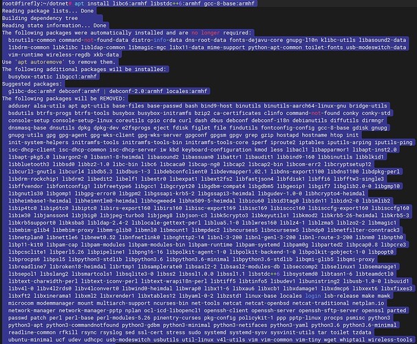

可以安装了 ,但是出现以下问题:
Use of uninitialized value $Text::WrapI18N::charmap in pattern match (m//) at /usr/share/perl5/Text/WrapI18N.pm line 137, line 18.
Use of uninitialized value $Text::WrapI18N::charmap in pattern match (m//) at /usr/share/perl5/Text/WrapI18N.pm line 155, line 18.
Can’t exec “/usr/bin/locale”: No such file or directory at /usr/share/perl5/Text/WrapI18N.pm line 134, line 18.
(Enter the items you want to select, separated by spaces.)
PAM profiles to enable:
