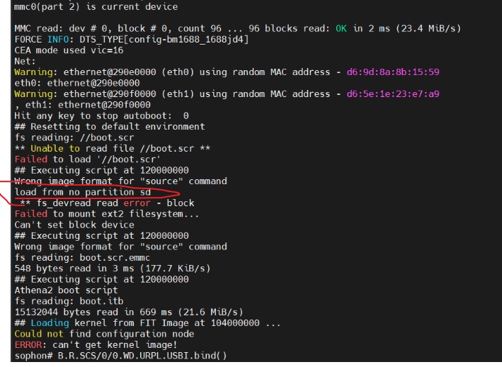

给我看看,插卡上电的时候,系统打印的第一段日志
请看错误日志
sophon#
sophon# B.R.SCS/0/0.WD.URPL.SDI/25000000/6000000.BS/SD.PS.SD/0x0/0x1000/0x1000/0.PE.BS.SD/0x1000/0x16800/0x16800/0.BE.J.

switch to partitions #2, OK
mmc0(part 2) is current device
MMC read: dev # 0, block # 0, count 96 ... 96 blocks read: OK in 2 ms (23.4 MiB/s)
FORCE INFO: DTS_TYPE[config-bm1688_1688jd4]
hdmi disconnected
Net:
Warning: ethernet@290e0000 (eth0) using random MAC address - 72:4f:26:37:a3:73
eth0: ethernet@290e0000
Warning: ethernet@290f0000 (eth1) using random MAC address - 0a:dd:b3:96:48:9b
, eth1: ethernet@290f0000
Hit any key to stop autoboot:  0
## Resetting to default environment
fs reading: //boot.scr
** Unable to read file //boot.scr **
Failed to load '//boot.scr'
## Executing script at 120000000
Wrong image format for "source" command
load from no partition sd
 ** fs_devread read error - block
Failed to mount ext2 filesystem...
Can't set block device
fs reading: boot.scr.emmc
548 bytes read in 3 ms (177.7 KiB/s)
Athena2 boot script
fs reading: boot.itb
18878170 bytes read in 834 ms (21.6 MiB/s)
## Loading kernel from FIT Image at 104000000 ...
Could not find configuration node
ERROR: can't get kernel image!
sophon#
