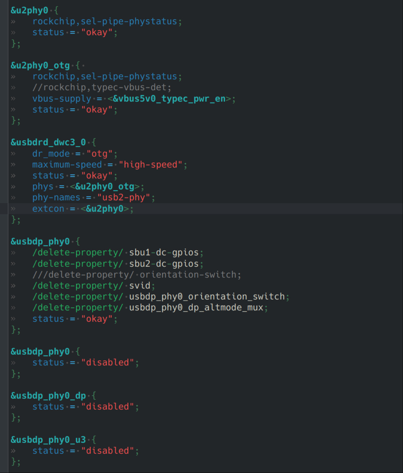

  1. DTS更改为如下配置:
这样配置, 切换为host枚举U盘正常。

  1. 完全使用客服发过来的devcie-only dtsi配置:
表现是默认为device模式,也是无反应,主机端未看到有任何枚举动作:
&usbdrd_dwc3_0 {
status = "okay";
dr_mode = "peripheral";
&u2phy0 {
status = "okay";
&u2phy0_otg {
status = “okay”;
&usbdp_phy0 {
/delete-property/ sbu1-dc-gpios;
/delete-property/ sbu2-dc-gpios;
/delete-property/ orientation-switch;
/delete-property/ svid;
/delete-property/ usbdp_phy0_orientation_switch;
/delete-property/ usbdp_phy0_dp_altmode_mux;
status = "okay";
&usbdp_phy0_dp {
status = "okay";
&usbdp_phy0_u3 {
status = "okay";
