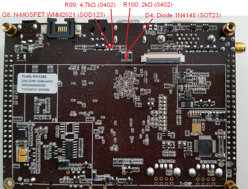

To support HDMI CEC, you need to:
  1. Hardware
Solder D4、Q8、R100、R99.
  1. Software
Please check this commit:
commit 3396ec0219458d4c1cb4f6177b594ebb141f8781Author: Firefly-RK3288
Date: ? Tue Nov 11 18:18:39 2014 +0800
hdmi : add cec support.

I made a picture of the hardware modifications, including infos about the electronic parts, see
D4: Diode 1N4148 (SOT23)
Q8: N-Channel MOSFET WNM2021 (SOD123)
R99: Resistor 4,7kΩ (0402)
R100: Resistor 2kΩ (0402)
Why wasn’t this included in the original HW? Asking users / developers to solder 0402 doesnt seem very reasonable and is very likely hurting adoption.
where can i buy it?
