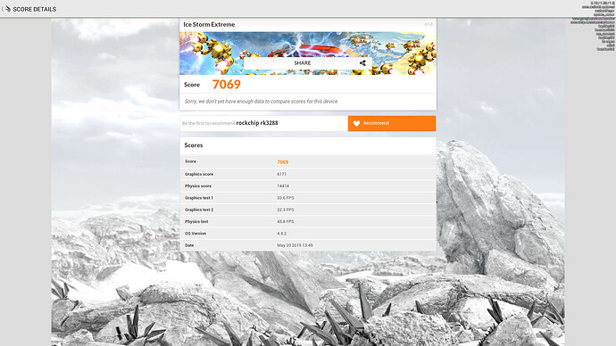

For reference, here is the Firefly 3DMark Ice Storm Benchmark: 7069
