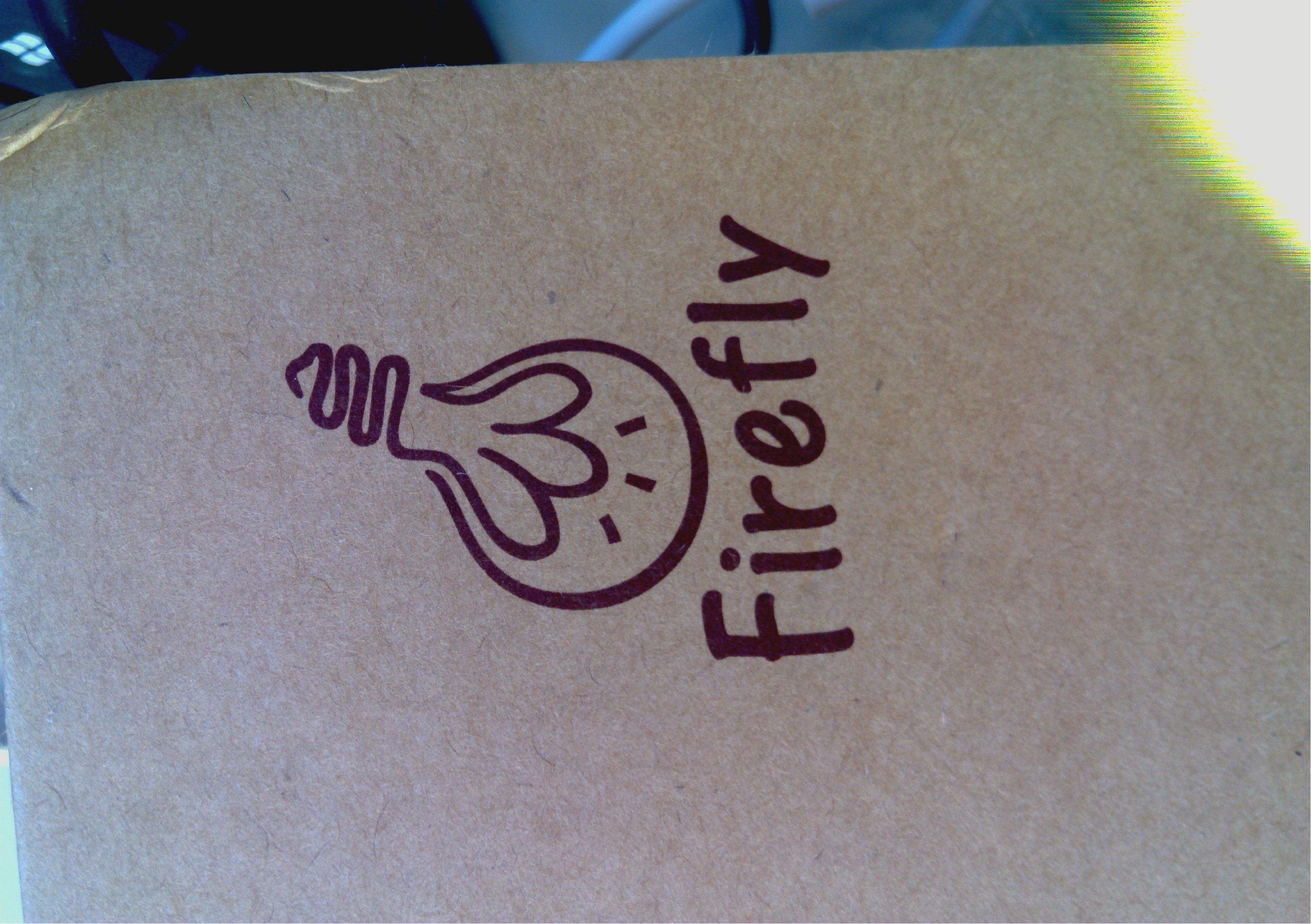

I ordered an OV13850 camera module from you, and I got the older version (without H marking). But I have a problem with it. The left bottom side is missing, or weird…
Is this the fault of the camera module?

As I said, I got the old version.
which commit have you updated to, and please attach the whole logcat file.
I no need to update, commit because I got the old version camera module.
logcat file
Here is the logcat file.log_Camera.zip (3.23 KB)
it is not a complete logcat.
and attach the whole dmesg log
I saved them with SysLog…
2016-04-13_09.40.zip (70.4 KB)
the firmware(Feb 25 2016 ) is for H version default
pls use the firmware before this date for nor H version
http://bbs.t-firefly.com/forum.php?mod=viewthread&tid=753
Thank you, the older firmware solved that image problem!!!
