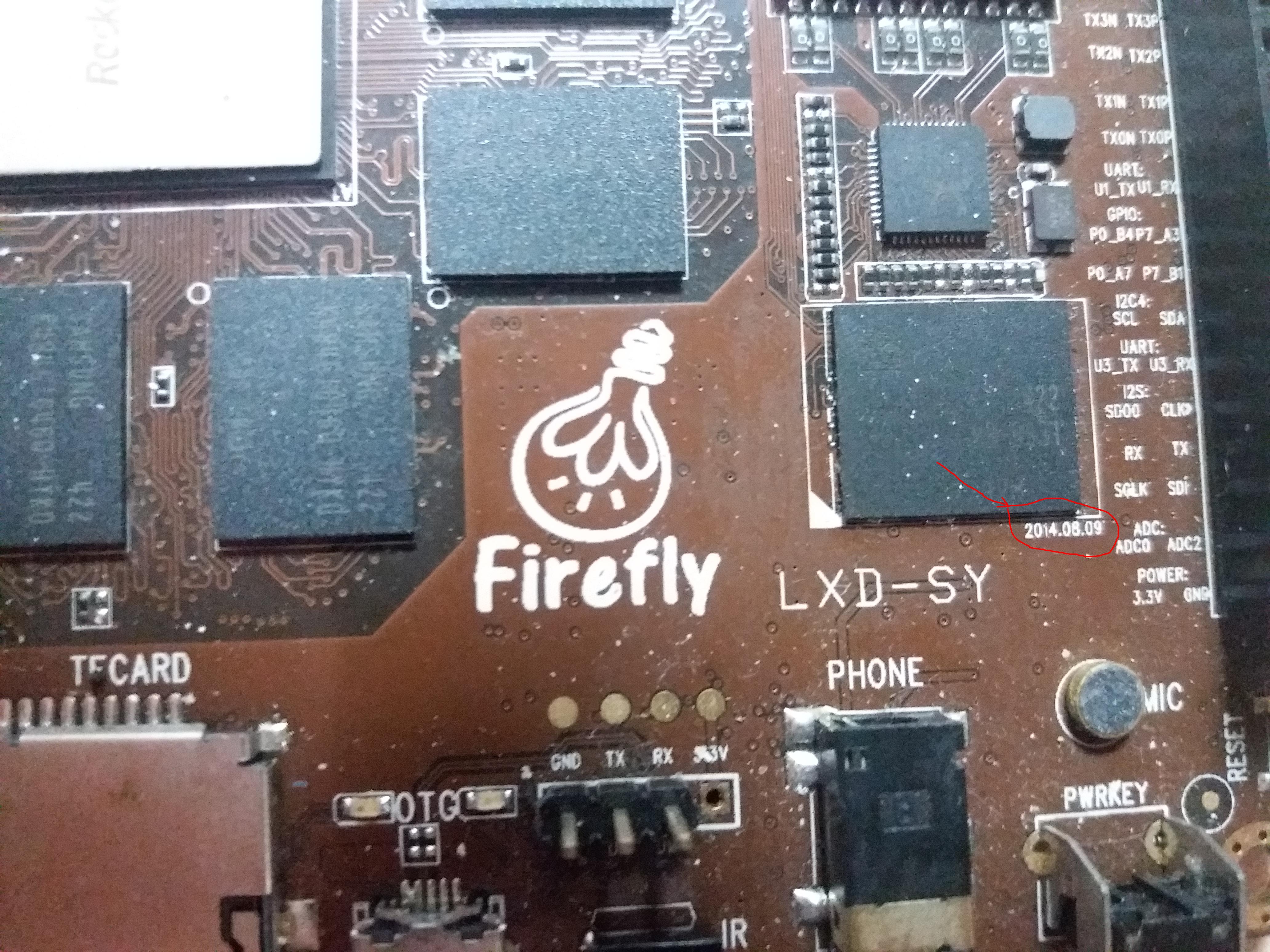

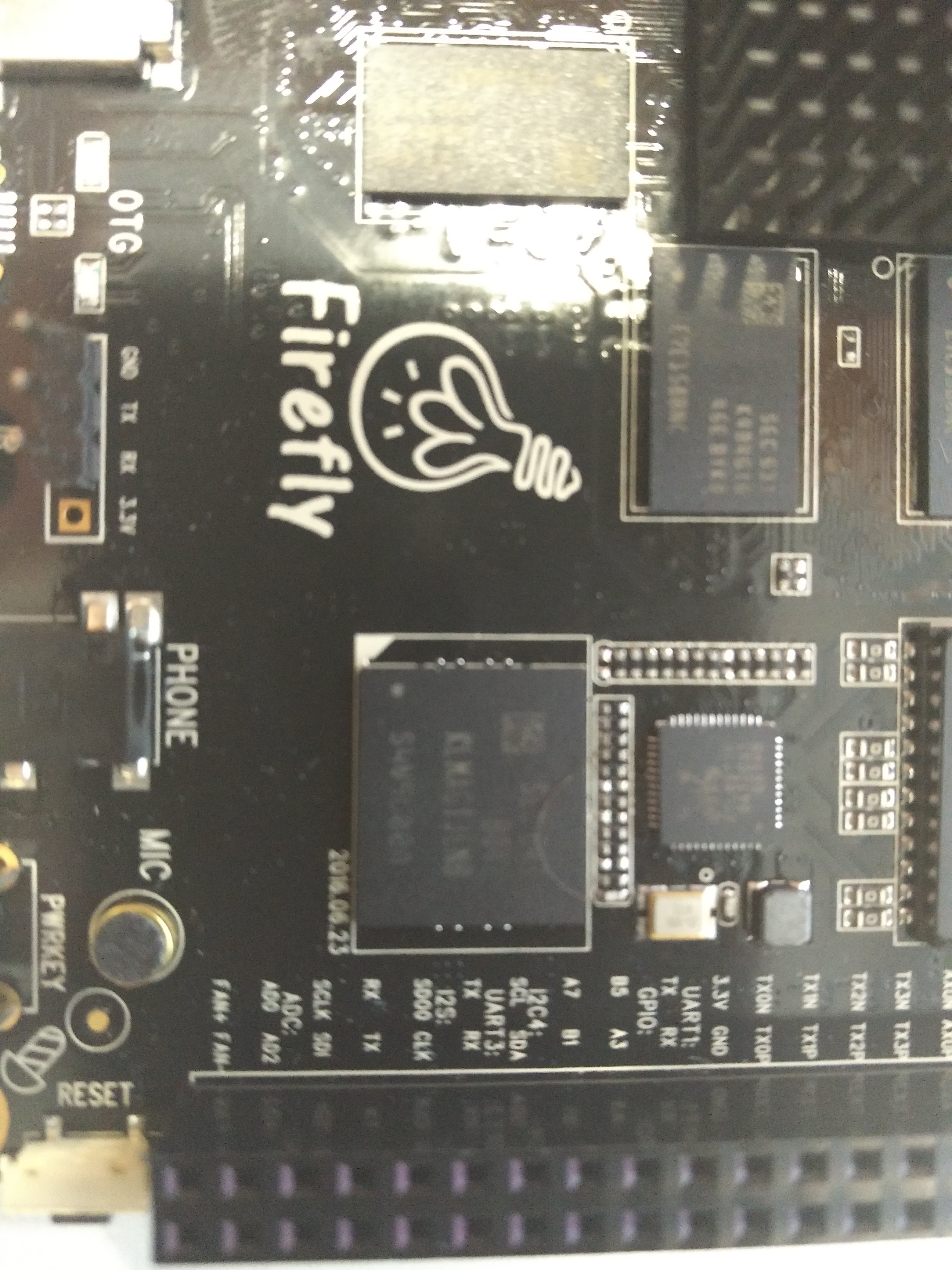

hi could you take a picture with the older and the newer board like this ?
Hi
Thanks for your reply. Hope the photos are okay.
The old board date read 2014.09.30
The new board date reads 2016.06.23
Thanks

Hi
these two boards have very little changes,so it shouldn’t show different results with the same image,
