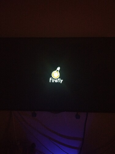

I updated image in mini box but it deleted by mistake . When i installed again .It does not work .Can you help me in this matter . It looks only blank screen .Kindly reply me.i will wait
not quiet sure about your problem ? Could you please give more information?
what “mini box” is ?
hi sir,i mean to say.i updated image in my mini box .when it switch on tv screen .it looks like this picture.i think there is no driver active in mini box.that is my first experience to use it.kindly help me in this matter.if you have any doubt about problem .i will clarify
Senial Debug .
