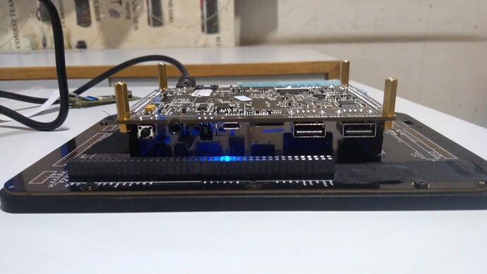

Hi all
I have 7.85" lcd module -eDP pin header version of rk3288.It’s not working after mounting rk3288 development board over it,not even its backlight is turning on.
Is there any issue with the firmware of development board.l have installed android 5.1.1 on it(kernal version:-3.10.0).
hi,you can use the firmware as follow link
https://drive.google.com/open?id=1iSfJ5NFWWejKxHhyXZ9ZsQOB9jim2iHR
then add the patch in your codec as follow link
http://dev.t-firefly.com/forum.php?mod=viewthread&tid=8121&highlight=7.85
