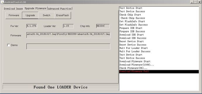

Dear All,
When I try to upgrade this img file I gave check firmware error. Pls check shared picture.

Please see: http://wiki.t-firefly.com/en/Firefly-RK3399/flashing-notes.html
Use Android Tool 2.58 to flash.
I tried and it is ok now. But at that time i have this bug and i gave the same bug for 16.04 ubuntu also;
