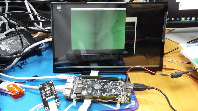

I had ROC-RK3399-PC with OV13850
I sucessed Camera Operation
But Color is not normal
Green color is too strong. what is the error?

It is required to use ISP to adjust the color, afaik.
Check this thread and script inside:
http://bbs.t-firefly.com/forum.php?mod=viewthread&tid=2490&extra=page%3D1
thanks..I did it
I needed 3 libraries
1.librkisp.so
2.libgstrkisp.so
3.libxcam_core.so.1 and libxcam_rkisp.so.1
and run dual-camera-rkisp.sh
