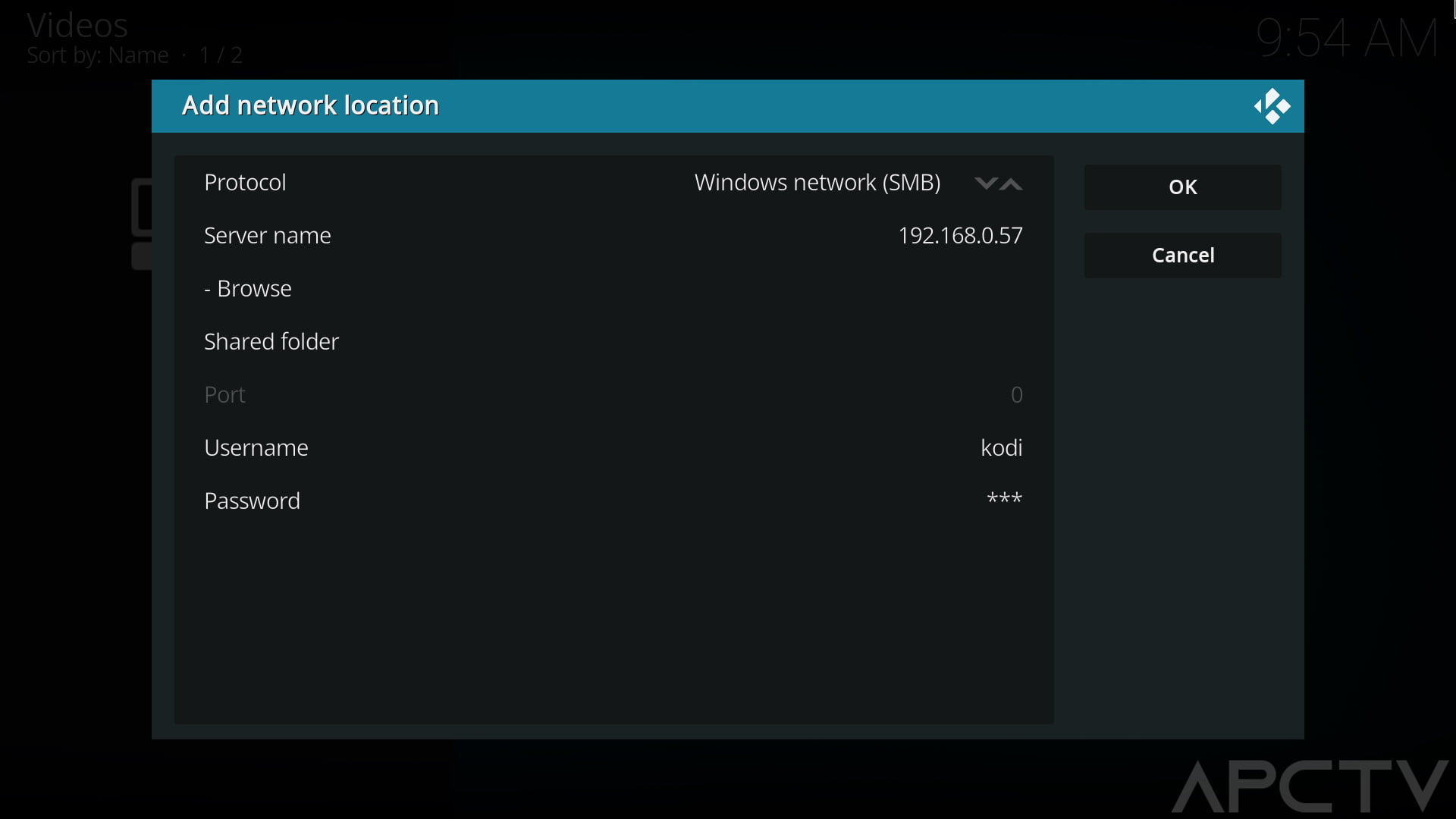

Run KODI and configure the access to our SAMBA network.
  • – Inside KODI go to Videos > Files > Add Videos
  • – Click on Browse > Add Network Location

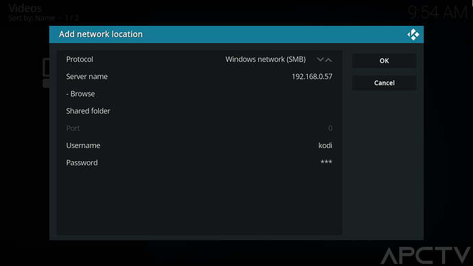

We fill in the data with the IP of our PC and the user data created earlier
  • – Server name = 192.168.0.XX (the IP of our PC)
  • – Username = kodi
  • Password = abc–
  • Click OK
Select the new SAMBA connection created and click OK > OK > OK in the menus.
