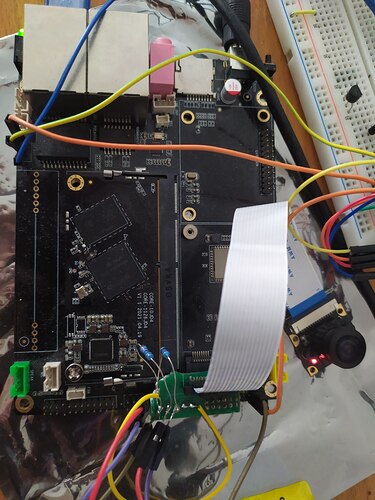

Board boots into recovery mode
My board seems to boot into recovery mode instead of normal mode. I have tested two boards and the same problem occurs, so it can’t be a hardware issue. Why doesn’t it boot normally?
My log:

Please provide the model of the development board you purchased
Core-1126-JD4 v1.1
Fuzzy1 Posted at 4/21/2022 09:58
Core-1126-JD4 v1.1
1、Did you use the official firmware for burning?
2、Have hardware repairs been performed?
3、Provide the name of the firmware you burned.
  1. I compile the firmware:
    ./build.sh device/rockchip/rv1126_rv1109/aio-rv1126-jd4-v11.mk
  2. No, I have flashed the same firmware on two different Core-1126-JD4 v1.1 boards and the same problem occurs.
  3. I compile my own custom firmware. Flashing:
    sudo ./rkflash.sh
    [sudo] password for fredrik:
    flash all images as default
    Program Data in /home/fredrik/FireflyRV1126/tools/linux/Linux_Upgrade_Tool/Linux_Upgrade_Tool

Are you using our baseboards?
Could you take a picture?
799959745 Posted at 4/22/2022 09:29
Yes, I’m using the baseboard MB-JD4-RV11091126. I’ll take a picture later.
