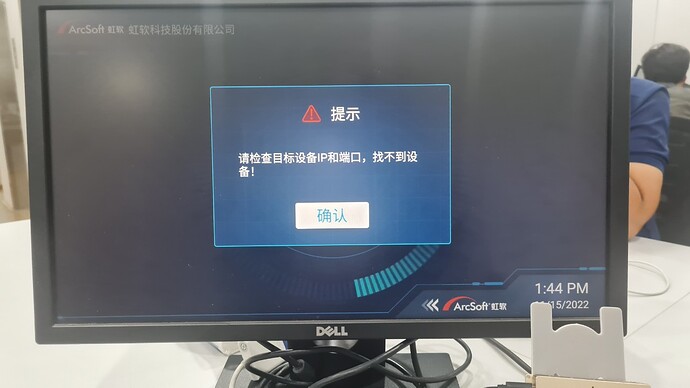

I have follow the instruction and setup the camera as AI_UVC, it’s working good when connected to Windows 10. But when I connect the camera to Android 11 Box using USB 3.0 port, it is not working, and it is display an error message as attached file. Please help me with this.
