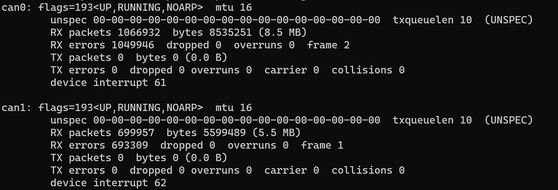

I will attach a screen shot showing the ifconfig read out. It shows both can bus interfaces with lots of errors but note they weren’t connected at the same time, the interfaces were tested separately.
