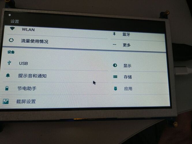

修改外分辨率后为什么显示不全

根据教程把 hdmi分辨率调成1024x600,接到我的HDMI7寸屏幕上,为什么只显示一部分。在显示器上显示正常。
			timing1: timing1 {
				screen-type = <SCREEN_RGB>;
				out-face    = <OUT_P888>;
				color-mode = <COLOR_YCBCR>;
				clock-frequency = <51200000>;
				hactive = <1024>;
				vactive = <600>;
				hback-porch = <140>;
				hfront-porch = <160>;
				vback-porch = <20>;
				vfront-porch = <12>;
				hsync-len = <20>;
				vsync-len = <4>;
				hsync-active = <0>;
				vsync-active = <0>;
				de-active = <0>;
				pixelclk-active = <0>;
				swap-rb = <0>;
				swap-rg = <0>;
				swap-gb = <0>;
android 5.1
rk3288 2G 32G
谁给看看呀
