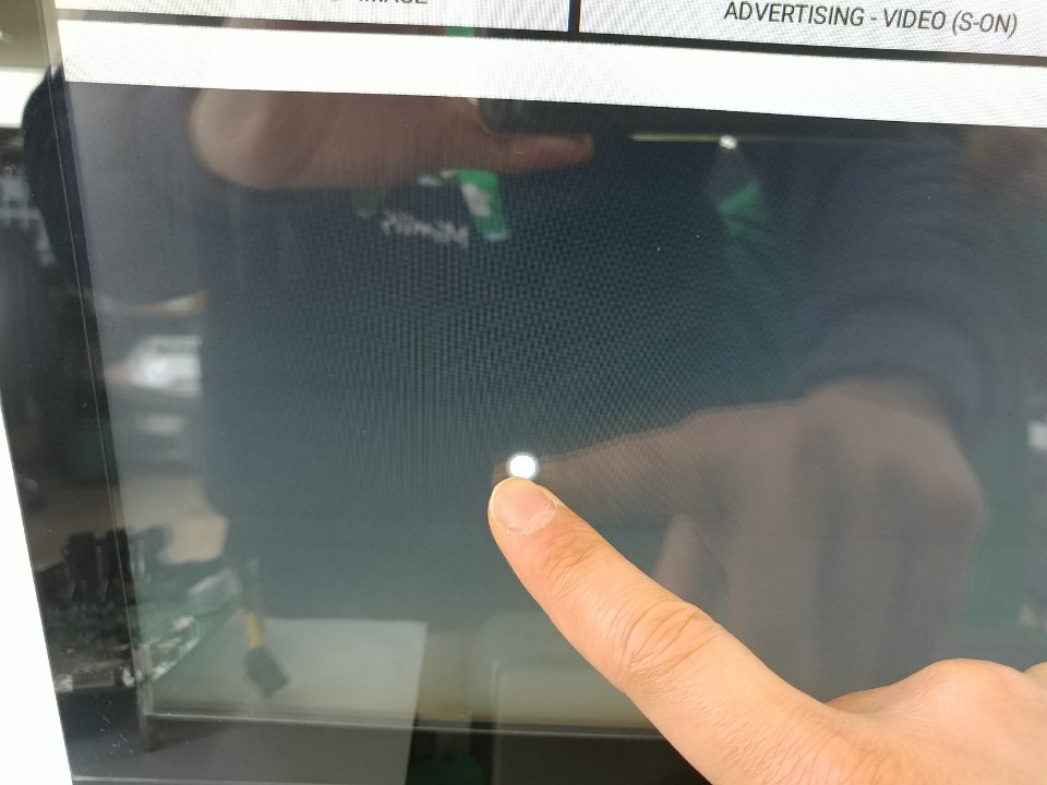

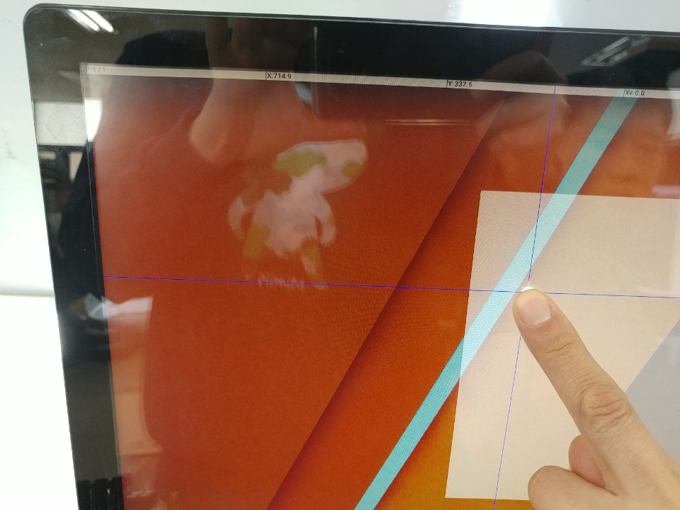

The attached picture is a picture that was touched in clone view mode and differnt view mode with the “Pointer location” and “Show Touches” option turned on.
When touched in the clone view, the touch marks and coordinates are displayed. (CloneViewMode_VgaTouch.jpg)
If touced in the diffrent view, only the touch marks are displayed and the coordinates are not displayed. (DifferentViewMode_VgaTouch.jpg)
