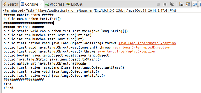

好,现在上代码:lol
package com.bunchen.test;
import java.lang.reflect.Constructor;
import java.lang.reflect.Method;
public class Test {
	public int func(int a , int b){
		return a+b;
	 * @hide
	public int func(int a){
		return a*a;
	public static void main(String[] args) {
		try {
			Class cls = Class.forName("com.bunchen.test.Test");
			Constructor[] cs = cls.getConstructors();
			System.out.println("###### constructors ######");
			for(Constructor c : cs){
				System.out.println(c.toString());
			System.out.println("##########################");
			Method[] mtds = cls.getMethods();
			System.out.println("###### methods ######");
			for(Method m : mtds){
				System.out.println(m.toString());
			System.out.println("#####################");
			Method m1 = cls.getMethod("func", int.class,int.class);
			Method m2 = cls.getMethod("func",int.class);
			Object obj = cls.getConstructor().newInstance();
			int a = 3 ;
			int b = 5 ;
			int r1 = (Integer) m1.invoke(obj, a,b);
			int r2 = (Integer) m2.invoke(obj, b);
			System.out.println("r1="+r1);
			System.out.println("r2="+r2);
		} catch (Exception e) {
			e.printStackTrace();
运行结果:
最后的最后,用这种方法我们就可以调用android隐藏了的api的方法了。:lol
