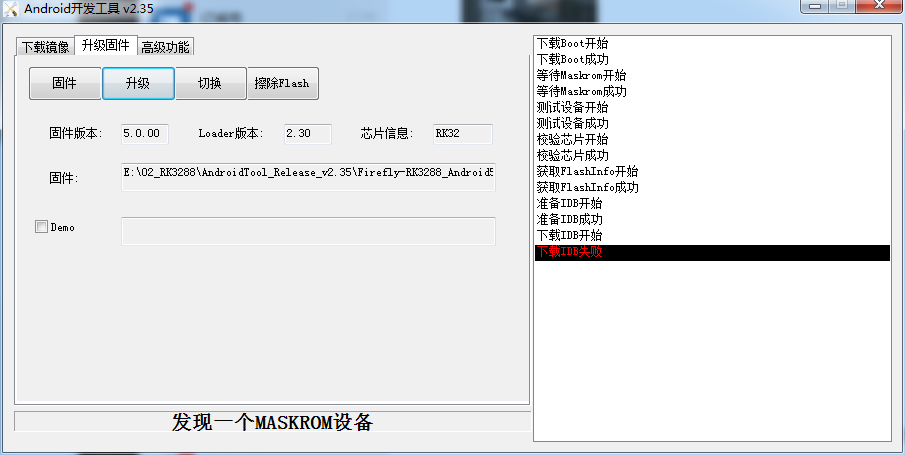

RK3288 自己的板子,发现MASKROM下载IDB失败,复位后出现LOADER设备,就变检验固件...

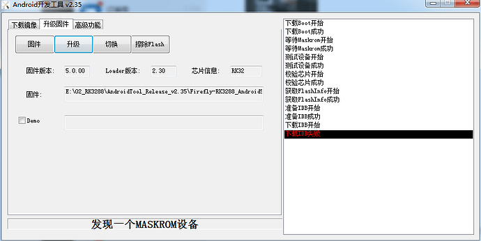

RK3288 自己的板子,发现MASKROM下载IDB失败,如图1

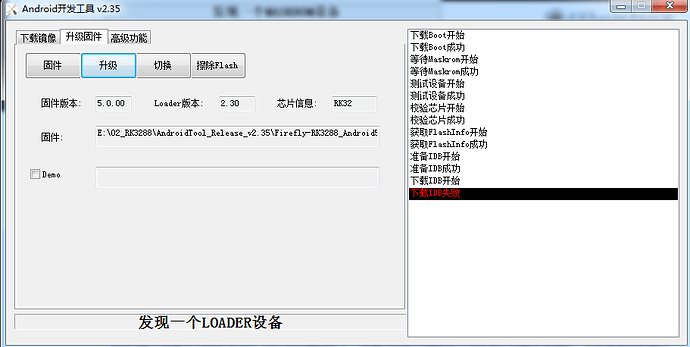

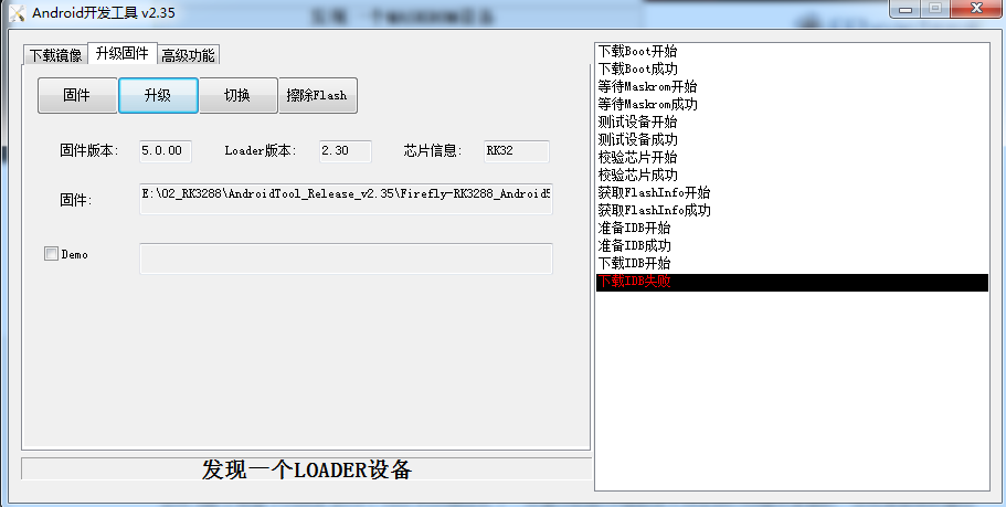

复位后出现LOADER设备,如图2
,,,就变检验固件失败,而又可以擦除成功,各位路过大神又遇见过的 吗?
附上 MASKROM设备,下载IDB失败;复位后loader设备 的 log

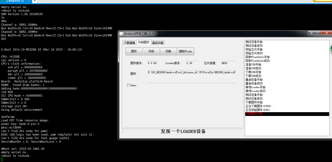

附上 loader设备 校验固件 失败 的 flog
DR Version 1.00 20160530
In
SRX
Channel a: DDR3 200MHz
Bus Width=32 Col=10 Bank=8 Row=15 CS=1 Die Bus-Width=16 Size=1024MB
Channel b: DDR3 200MHz
OUT
U-Boot 2014.10-RK3288-10 (Mar 18 2019 - 18:00:13)
CPU: rk3288
cpu version = 0
CPU’s clock information:
arm pll = 600000000HZ
periph pll = 297000000HZ
ddr pll = 200000000HZ
codec pll = 384000000HZ
Board: Rockchip platform Board
DRAM: Found dram banks: 1
Adding bank:0000000000000000(0000000080000000)
128 MiB
GIC CPU mask = 0x00000001
SdmmcInit = 0 400
SdmmcInit = 2 0
storage init OK!
Using default environment
GetParam
W: Invalid Parameter’s tag (0xFFFFFFFF)!
Invalid parameter
No pmic detect.
SecureBootEn = 0, SecureBootLock = 0
#Boot ver: 2019-03-18#2.30
empty serial no.
reboot to rockusb.
DDR Version 1.00 20160530
In
SRX
OUT
CPU: rk3288
cpu version = 0
128 MiB
SdmmcInit = 0 400
SdmmcInit = 2 0
storage init OK!
GetParam
Load FDT from resource image.
power key: bank-0 pin-5
pmic:act8846
can’t find dts node for pwm1
DCDC vdd_logic has been used, pwm regulator not init it.
Can’t find dts node for fuel guage cw201x
empty serial no.
reboot to rockusb.
如图loader设备 校验固件 失败 的 flog
