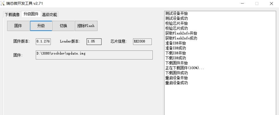

编译出的固件要刷机时候提示加载固件失败
按照编译固件 说明操作 git pull gitlab firefly:firefly 更新SDK后采用的是全自动编译方式 在SDK目录下执行了一些两条指令./build.sh roc-rk3308b-cc-plus_release_BoardConfig.mk./build.sh编译 过程 终端打印输出了差不多两个多小时 才结束 中间闪过一些WARNING最后的信息 Allocating group tables: done Writing inode tables: done Copying files into the device: doneWriting superblocks and filesystem accounting information: donetune2fs 1.43.9 (8-Feb-2018)Setting maximal mount count to -1Setting interval between checks to 0 secondsdone.create uboot.img…done.create trust.img…done.create loader…done.create boot.img…done. Image: image in rockdev is ready Make image ok!Make update.imgstart to make update.img…Android Firmware Package Tool v1.65------ PACKAGE ------Add file: ./package-fileAdd file: ./Image/MiniLoaderAll.binAdd file: ./Image/parameter.txtAdd file: ./Image/trust.imgAdd file: ./Image/uboot.imgAdd file: ./Image/boot.imgAdd file: ./Image/rootfs.imgAdd file: ./Image/recovery.imgAdd file: ./Image/oem.imgAdd file: ./Image/userdata.imgAdd file: ./Image/misc.imgAdd CRC…Make firmware OK!------ OK ------RKImageMaker ver 1.66Generating new image, please wait…Writing head info…Writing boot file…Writing firmware…Generating MD5 data…MD5 data generated successfully!New image generated successfully!Making update.img OK./home/Firefly-RK3308Make update image ok!,根据说明文档找到了tools/linux/Linux_Pack_Firmware/rockdev/image 文件下的把 update.img 复制出虚拟机后加载到固件中要 测试 结果报错加载固件失败
这是哪里出问题了?
这截图无法放到帖子上?

这个是全自动化编译脚 完成后生产的.img文件 为什么不是像官网上下载的那么有1个G那么大?
官网固件有三种:buildroot,qt demo,ubuntu,固件大小都不一样的,具体看维基教程。
