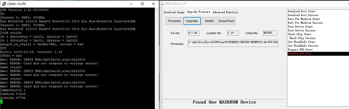

The firmware suggested was already tried. After being off for a couple
of days, it showed up in Maskrom mode this morning. I tried the firmware
from the link and it fails. Here is the screen capture of the results:
Please let me know what else I can do!
Thanks!See the attached
I’m attaching the image which might not have gotten through.The log file showed:11:18:53 452 RKDevTool v[link removed] start run11:20:37 913 Layer<1-3>:Download Boot Start11:20:41 757 Layer<1-3>:Download Boot Success11:20:41 759 Layer<1-3>:Wait For Maskrom Start11:20:42 227 Layer<1-3>:Wait For Maskrom Success11:20:42 231 Layer<1-3>:Test Device Start11:20:42 234 Layer<1-3>:Test Device Success11:20:42 238 Layer<1-3>:Check Chip Start11:20:42 241 Layer<1-3>: Check Chip Success11:20:42 244 Layer<1-3>:Get FlashInfo Start11:20:42 245 <LAYER 1-3> INFO:FlashInfo: 00 00 00 00 00 04 04 00 28 00 0011:20:42 247 <LAYER 1-3> INFO:GetFlashInfo–>Emmc storage.11:20:42 252 Layer<1-3>:Get FlashInfo Success11:20:42 255 Layer<1-3>:Prepare IDB Start11:20:42 256 <LAYER 1-3> ERROR:PrepareIDB–>No Found 1st Flash CS11:20:42 259 Error:Layer<1-3>:Prepare IDB FailAnd the UART output showed:DDR Version 1.22 20190506InChannel 0: DDR3, 800MHzBus Width=32 Col=10 Bank=8 Row=15/15 CS=2 Die Bus-Width=16 Size=2048MBChannel 1: DDR3, 800MHzBus Width=32 Col=10 Bank=8 Row=15/15 CS=2 Die Bus-Width=16 Size=2048MB256B stridech 0 ddrconfig = 0x101, ddrsize = 0x2020ch 1 ddrconfig = 0x101, ddrsize = 0x2020pmugrf_os_reg[2] = 0x3AA17AA1, stride = 0xDOUTBoot1: 2019-03-14, version: 1.19CPUId = 0x0mmc: ERROR: SDHCI ERR:cmd:0x102,stat:0x18000mmc: ERROR: Card did not respond to voltage select!emmc reinitmmc: ERROR: SDHCI ERR:cmd:0x102,stat:0x18000mmc: ERROR: Card did not respond to voltage select!emmc reinitmmc: ERROR: SDHCI ERR:cmd:0x102,stat:0x18000mmc: ERROR: Card did not respond to voltage select!SdmmcInit=2 1UsbHook 57663powerOn 57746

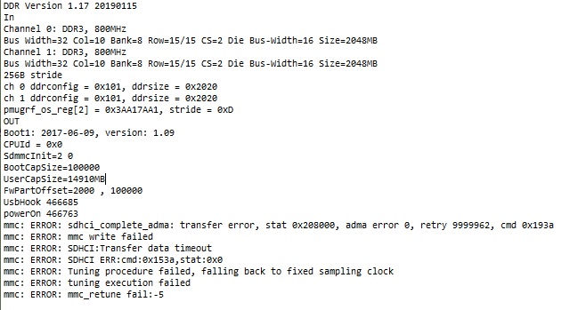

Here is the erase working:
Here is the Upgrade Firmware failing:
And, here is the download image attempt failing:
, Android no longer loads onto the device. All updates fail with IDB problems. I have not found any tools which will clear the error and allow anything to be stored into the EMMC.
