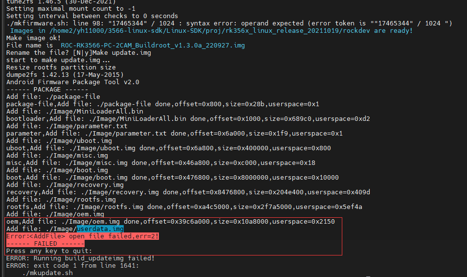

roc-rk3566-pc-buildroot.mk固件打包错误
固件文件名称:rk356x_linux_release_20211019
Log日志:log.txt
yh11000@server3:/home2/yh11000/3566-linux-sdk/Linux-SDK/proj/rk356x_linux_release_20211019$ ./build.sh updateimg
processing option: updateimg
File name is ROC-RK3566-PC-2CAM_Buildroot_v1.3.0a_220927.img
Rename the file? [N|y]n
Make update.img
start to make update.img…
Resize rootfs partition size
dumpe2fs 1.42.13 (17-May-2015)
Android Firmware Package Tool v2.0
------ PACKAGE ------
Add file: ./package-file
package-file,Add file: ./package-file done,offset=0x800,size=0x28b,userspace=0x1
Add file: ./Image/MiniLoaderAll.bin
bootloader,Add file: ./Image/MiniLoaderAll.bin done,offset=0x1000,size=0x689c0,userspace=0xd2
Add file: ./Image/parameter.txt
parameter,Add file: ./Image/parameter.txt done,offset=0x6a000,size=0x1f9,userspace=0x1
Add file: ./Image/uboot.img
uboot,Add file: ./Image/uboot.img done,offset=0x6a800,size=0x400000,userspace=0x800
Add file: ./Image/misc.img
misc,Add file: ./Image/misc.img done,offset=0x46a800,size=0xc000,userspace=0x18
Add file: ./Image/boot.img
boot,Add file: ./Image/boot.img done,offset=0x476800,size=0x8000000,userspace=0x10000
Add file: ./Image/recovery.img
recovery,Add file: ./Image/recovery.img done,offset=0x8476800,size=0x204e600,userspace=0x409d
Add file: ./Image/rootfs.img
rootfs,Add file: ./Image/rootfs.img done,offset=0xa4c5000,size=0x2f7a9000,userspace=0x5ef52
Add file: ./Image/oem.img
oem,Add file: ./Image/oem.img done,offset=0x39c6e000,size=0x10a8000,userspace=0x2150
Add file: ./Image/userdata.img
Error: open file failed,err=2!
------ FAILED ------
Press any key to quit:
ERROR: Running build_updateimg failed!
ERROR: exit code 1 from line 1641:
./mkupdate.sh

你的 packge-file 不对,你是否有更新 SDK ?是否自行修改过 device/rockchip 仓库和 tools 仓库?

您好, 这是我的package-file, 请问是哪里不对呢

在 sdk 根目录执行 repo status,看看你哪个仓库有改动

那就是你修改了device/rockchip里的分区表rk356x/parameter-buildroot-fit.txt导致的

git reset --hard HEAD还原回去,然后再编译试试
执行 ./mkfirmware.sh 链接文件;
看下有没有 userdata.img,ls -l rockdev/

./mkfirmware.sh: line 98: “4194304” / 1024 : syntax error: operand expected (error token is "“4194304” / 1024 ")
Linking MiniLoaderAll.bin from /home2/yh11000/3566-linux-sdk/rk356x_linux_release_20211019/u-boot/rk356x_spl_loader_v1.13.112.bin…
Done linking MiniLoaderAll.bin
Linking boot.img from /home2/yh11000/3566-linux-sdk/rk356x_linux_release_20211019/kernel/extboot.img…
./mkfirmware.sh: line 98: “134217728” / 1024 : syntax error: operand expected (error token is "“134217728” / 1024 ")
Linking recovery.img from /home2/yh11000/3566-linux-sdk/rk356x_linux_release_20211019/buildroot/output/rockchip_rk356x_recovery/images/recovery.img…
./mkfirmware.sh: line 98: “33886208” / 1024 : syntax error: operand expected (error token is "“33886208” / 1024 ")
Linking misc.img from /home2/yh11000/3566-linux-sdk/rk356x_linux_release_20211019/device/rockchip/rockimg/misc.img…
Fallback to /home2/yh11000/3566-linux-sdk/rk356x_linux_release_20211019/device/rockchip/rockimg/wipe_all-misc.img
./mkfirmware.sh: line 98: “49152” / 1024 : syntax error: operand expected (error token is "“49152” / 1024 ")
Linking rootfs.img from /home2/yh11000/3566-linux-sdk/rk356x_linux_release_20211019/rockdev/rootfs.ext4…
./mkfirmware.sh: line 98: “54” / 1024 : syntax error: operand expected (error token is "“54” / 1024 ")

./mkfirmware.sh: line 98: “17465344” / 1024 : syntax error: operand expected (error token is "“17465344” / 1024 ")
Images in /home2/yh11000/3566-linux-sdk/rk356x_linux_release_20211019/rockdev are ready!
ls -l rockdev/

您好, 没有 userdata.img 文件

您好, 重新编译好多次了, 还是不行, 一样的问题
向朗向明朗 发表于 2022-9-29 13:29
./mkfirmware.sh
/usr/bin/fakeroot
Source buildroot/build/envsetup.sh
按下面,把 device/rockchip/common/mkfirmware.sh 的 PART_SIZE 这行改掉,再按之前的操作。
diff --git a/common/mkfirmware.sh b/common/mkfirmware.sh
index 9cde466..7f5113d 100755
— a/common/mkfirmware.sh
+++ b/common/mkfirmware.sh
@@ -85,7 +85,7 @@ assert_size() {
 IMG_SIZE=$(stat -c "%s" "$IMG")
  • if [ $PART_SIZE -lt $(( “$IMG_SIZE” / 1024 )) ]; then
  • if [ $PART_SIZE -lt $(( $IMG_SIZE / 1024 )) ]; then
    fatal “error: $IMG’s size exceed parameter.txt’s limit!”
    fi
diff - …
谢谢谢谢, 编过了, 感谢两位前辈的帮助 谢谢
这个问题在ubuntu18上应该不会出现,所以你是在ubuntu16上编译的吧
维基里说了推荐ubuntu18,用别的就会出现这种奇奇怪怪的问题
下次要记得按照维基推荐来部署环境
维基里说了推荐ubuntu18,用别的就会 …
是的 确实是部署的环境有问题, 谢谢指点
