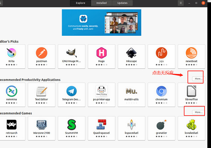

另外发现两个问题:一个是安装vlc播放没有画面日志如下,另外一个是software中点击more按钮无反应
Aug 26 12:00:18 firefly gnome-shell[1351]: Window manager warning: Invalid WM_TRANSIENT_FOR window 0x1e00008 specified for 0x1e00027.
Aug 26 12:00:22 firefly mpp[10824]: mpp_info: mpp version: 658e1ed8 author: daijh         2022-11-17 update version
Aug 26 12:00:22 firefly mpp[10824]: hal_h264d_vdpu34x: control info: fmt 7, w 1920, h 1080
Aug 26 12:00:22 firefly mpp[10824]: mpp_buf_slot: set frame info: w 1920 h 1080 hor 1920 ver 1088
Aug 26 12:00:22 firefly mpp[10824]: mpp_dec: setting default w 1920 h 1080 h_str 1920 v_str 1088
Aug 26 12:00:22 firefly mpp[10824]: h264d_sei: seq_parameter_set_id 0 may be invalid
