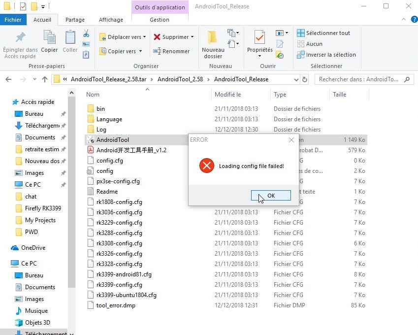

your Androidtools v2.58 Missing a file :config.ini
!(/home/daijh/图片/2018-12-18 09-52-17 的屏幕截图.png)
Hello,
thank you for your answer, but I have all the files, look it’s the same image as your screenshot.
The problem is that the file does not load, I think the program is not supported by windows10 64bits, it’s a track I think.

navigatoria Posted at 12/18/2018 16:11
Hello,
thank you for your answer, but I have all the files, look it’s the same image as your scr …
Are you sure you have this file? “config.ini” I can’t find it on your picture

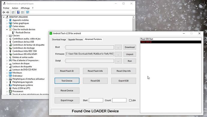

Hello,
ok I fixed the problem it works with windows10, I decompressed the AndroidTool archive and made it directly start from the usb key on windows10 (64bits). Android tool works but whatever I do it is impossible to access the “chip” I still have the error. As you can see on my screenshots, nothing works. I have no choice but to switch to maskrom but I can not do it, your tutorial on the wiki to go in MaskRom is very basic, I have a hard time doing it.
Yes, it works well, you do not see the extension config.ini because I have hidden the extentions for windows10 by default to erase them by mistake. For my problem, there is only one solution in my opinion enter MaskRom mode but as I said I can not do it, with the wiki I’m not doing it for this operation with a small iron tip.

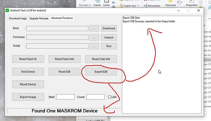

Hello,
after a lot of tests and attempts, I finally managed to enter the MaskRom mode! I did not believe it anymore !
But I am very worried, even in this mode I can not integrate a new firm, or even erase the old.
[b]An idea?
