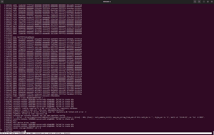

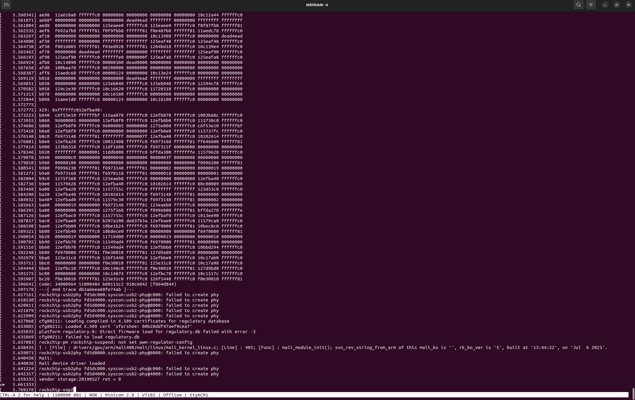

我使用这个dtsi,也卡住了。
[    4.653896] RKNPU fdab0000.npu: RKNPU: failed to get dynamic-coefficient
[    4.654993] cfg80211: Loading compiled-in X.509 certificates for regulatory database
[    4.655691] rockchip-usb2phy fd5d8000.syscon:usb2-phy@8000: failed to create phy
[    4.656129] rockchip-usb2phy fd5dc000.syscon:usb2-phy@c000: failed to create phy
[    4.656598] rockchip-usb2phy fd5d4000.syscon:usb2-phy@4000: failed to create phy
[    4.661046] cfg80211: Loaded X.509 cert 'sforshee: 00b28ddf47aef9cea7'
[    4.662571] platform regulatory.0: Direct firmware load for regulatory.db failed with error -2
[    4.662604] cfg80211: failed to load regulatory.db
[    4.663219] rockchip-pm rockchip-suspend: not set pwm-regulator-config
[    4.664240] I : [File] : drivers/gpu/arm/mali400/mali/linux/mali_kernel_linux.c; [Line] : 405; [Func] : mali_module_init(); svn_rev_string_from_arm of this mali_ko is '', rk_ko_ver .
[    4.664817] Mali:
[    4.664820] Mali device driver loaded
[    4.664912] rockchip-usb2phy fd5d8000.syscon:usb2-phy@8000: failed to create phy
[    4.665365] rockchip-usb2phy fd5dc000.syscon:usb2-phy@c000: failed to create phy
[    4.665840] rockchip-usb2phy fd5d4000.syscon:usb2-phy@4000: failed to create phy
v�   4.667574]
[    4.686313] vendor storage:20190527 ret = 0
定位不到是哪出的问题,有没有思路。
wind020 发表于 2023-7-6 15:42
我使用这个dtsi,也卡住了。
定位不到是哪出的问题,有没有思路。
我的自制板也是啊, 我参考其他的 log, 下一段应该是 IMX415,我在 kernel 中配置 disable 多媒体,disable 声卡, 没有解决问题。
请有知道的大佬给指出个方向,感谢!
